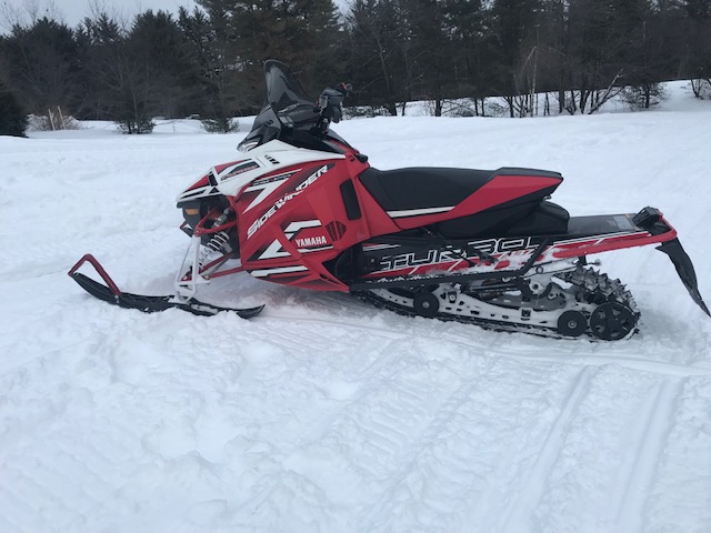

she's mine, just need to figure out which Skis to put on,
it's down to: SLP Mohawks
C&A MTX (C&A recommendation)
C&A XCS

I didn't know the 17 ltx le came in red?

Yep, spring order!I didn't know the 17 ltx le came in red?
