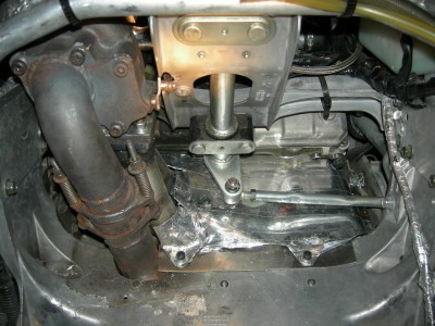

Got a pic of this D.D.P. Fern ?

Pretty slick looking Fern
Looks like it just bolts straight onto mine as it seems the the 5 bolt pattern is the same, all though your turbo does look bigger than mine.
How do you have the exhaust hooked up from the end of the DDP?
rx1 fern
yeah that is a 2560 in that picture .i now have a 2860 on it now.the exhaust goes into a straight pipe out to a carbon fiber hindle.i have that turbo still for sale if interested .it is ported and ceramic coated also with the bigger wastegate accuator.you wont be dissappointed with the ddp.
