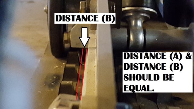

Absolutely this can happen. If the track is out of alignment (axle not adjusted properly), it will walk to one side and can cause excessive wear and damage components. The rear axle has a dual purpose adjustment: It aligns (pushing or pulling each side) and tightens (or loosens) the track simultaneously. If you adjust track tension, you need to check the alignment; vice a versa.Would it even be possible to have one end of the axle froward and one back causing the rear wheels to not be correctly aligned?
Look through the track windows to check alignment. Make sure there is equal distance between the drive lug edges and the hyfax edges on both sides.
If your track is too loose, the drivers will skip (ratchet) the drive lugs. If this happens, you'll have to tighten the track. You're running a lot of studs, so you may have to tighten the track even more.
View attachment 114849 View attachment 114850
So the track adjusters directly effect tension AND alignment?

Exactly! The more you screw the nut onto the bolt of the adjuster, the closer you pull the axle towards the rear, the tighter you make the track. Thats why it is so important to count your revolutions of each nut, if all your parts are in good shape, and you turn both nuts equally, be it 5 revolutions or 10 revolutions or whatever it takes to get to 1.25 inches sag in your track(track deflection)(distance between track and slider), you quite often end up with the track fairly well aligned. If not aligned, your left nut turned out or right nut turned in, or vice versa, will make that tweak. But let's hope you may not have to go that far. If you don't have one yet, you really do need a service manual. So much information there! Also, do check that left side adjuster, it may be flipped when you installed the kit(you should be able to see it). If so, put it back where it should be. What I do when I'm messing with that back axle, I loosen the axle nut(or remove), loosen the adjuster nuts(or remove)(count revolutions), pull track back with ratchet straps, and if for instance, I want to flip that left side adjuster, As I'm sliding the axle out of the passenger side, I'm pushing in a F350 tire iron(or similar) through the driver's side to keep all the pieces aligned. When you get to the adjuster, just flip it, and reverse the procedure.
ranger1
Once you have the proper sag (tension) & you have the same amount of threads on each bolt, run the track with the sled on a track stand, shut it down, then measure the distance between the hyfax & the outer edge of the track on both sides to make sure they are the same. If there is more track sticking out on one side you can either tighten that side or loosen the opposite side to correct it.

Remember, it doesn't have to be perfect to the millithousands of an inch. If I see space on one side, and I see almost same space on other side, I'm good to go. Eyeball only.

Think of your track as a conveyor belt, if both front and rear axles aren't running parallel to each other the belt will naturally want to track to one side. Doesnt take much adjustment to center the belt. Leave axle nut loose enough so you can fine tune the alignment then tighten up completely
The amount of exposed threads on adjuster being equal is a good starting point, they may not end up being equal when you get the track centered due to worn components and track condition.
ranger1
I would just loosen the one side until the track is centered as it is rare that both sides will have the exact same sag, the tracks seem to always be a bit longer on one side. eg might be 3/4" sag on one side then 5/8" on the other side, as long as it is centered you are good to go.I jsut changed my track,,,,i can't get my new one quite lined up....i got lots of studs so i been tighten same amount of turns til i get around 1/2 inch hang on both sides.....But One side is over 1/4 inch from lug to hyfax and the other side is like 3/4 of a 1/4 inch
