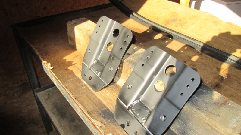

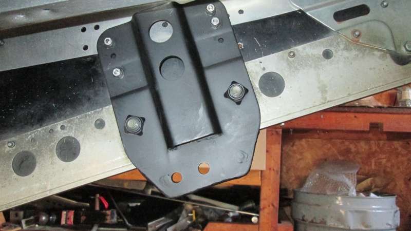

In case anyone is still interested, I just put an R-Motion suspension in my 2007 RTX (taken from a MXZ XRS 2012, revalved shocks) and the results are impressive. I never had that much fun with my RTX before!
You can use the front holes but you'll need to modify the original rear brackets.
I hope it will prove to be reliable enough in the long term. Here are some pics.
