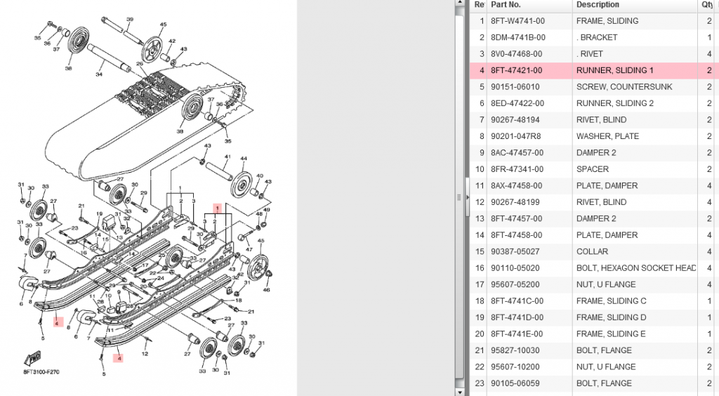

What is the sliding frame mentioned as a connection between both the front and rear pivot arms?
Looks like I went a bit heavy on a couple, only on the shock to the pivot arms. I'll loosen and redo.

Ya, I'm not entirely sure, it's a bit unclear, take a look at this though off the parts fiche. I think they are referring to the bolt that holds the slider to the rail.
The apex GT and ER will be the same as the Attak GT and ER. The RX10RTRL is a Apex RTX with the other suspension. I'm not sure which suspension the mountain has though.

Thanks. And yes, that's the conclusion I came to as well, the actual rail itself.
