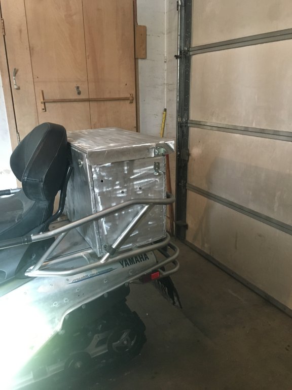

I couldn't find a box to fit my needs so I slowly (all winter) built one out of scrap aluminum. It can snugly hold my ice auger, axe and 2 amo boxes full of stuff. I don't carry the auger often so lots of room for back pack, food, coffee or whatever. Everything has a place and is secured. Not finished yet as I have all summer to add too it and paint. It will be permanently mounted. Wired inside with a LED light, 12 volt plug in and maybe cigaret lighter.Lots of work planning this box but worth it! Cost me so far about $30....
Finished product. And added a Pintel hitch plus work light on back and in box.

Good jobI couldn't find a box to fit my needs so I slowly (all winter) built one out of scrap aluminum. It can snugly hold my ice auger, axe and 2 amo boxes full of stuff. I don't carry the auger often so lots of room for back pack, food, coffee or whatever. Everything has a place and is secured. Not finished yet as I have all summer to add too it and paint. It will be permanently mounted. Wired inside with a LED light, 12 volt plug in and maybe cigaret lighter.

Are the corners of the box continuous welded?

U-bolts will work too. I want to make sure clamps can't be removed and bolted from the inside. Harder to steal. Not that I'm too concerned of this happening, but I'd be so mad because of all the work in planning and building.I would suggest 1/4" x 1-1/4"-1-1/2" stainless u-bolts for your box. I would slip some 5/16 rubber tubing over them to reduce damage to the paint on the rack rails. Looks like you can secure to the side and/or bottom rack rails with the fit of your box.
No the seams are riveted, not welded. Local shop wants $125 to tig weld. Not sure if I will spend the money
