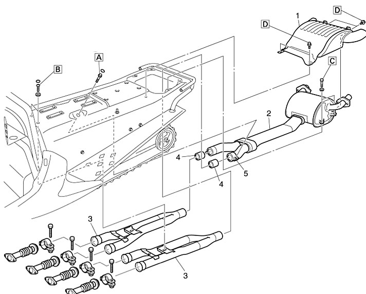

In addition you will most likely have to:
-remove rear tailpipe painted shrouds
-remove bumper shroud
-drop skid
-remove rear muffler heat shield
here is a good picture from parts fiche to see how it all goes together..
hope that helps ya
