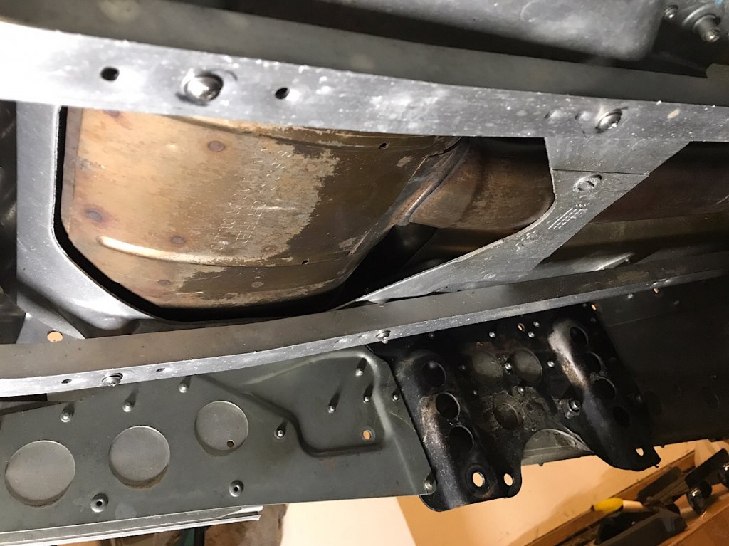

Ok, this seems a lot better.
I had to pull the seat and just loosen the muffler and lift it a bit. There was enough play without forcing it up to let me get to the screw.
I was able to get to the rear screws by reaching up from inside the tunnel. Does this seem ok? Not sure I have much choices at this point, since I can't rivet, unless I fabricated some type of U bracket that held the tubes from the sides. I put it all back together though, as I'm pretty sure this won't present a problem.

Looks Great I would have no concern with that set up.

That won't catch the track!
