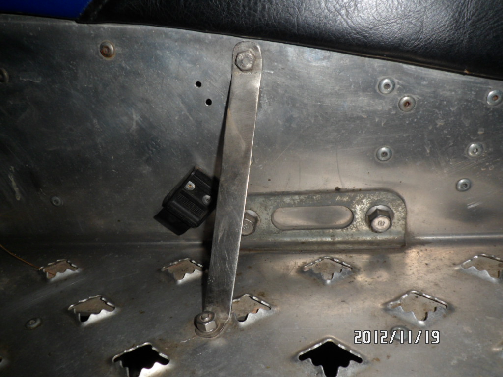

The rivets I used are 3/16" I think and are plated steel, not aluminum. I enclosed a couple of pic's of the bracket that I built after my 3rd cooler crack. I think that they crack because the running board flexes when you put all of your weight on them and the suspension mount is right there and is causing the stress to the cooler. The support bracket will not allow the tunnel to flex there. Been working for 3 years now.
In the second pic you can see the bracket that I add because the tunnel was flexing up when I tied my bags down on bagger trips. Just a precaution.
