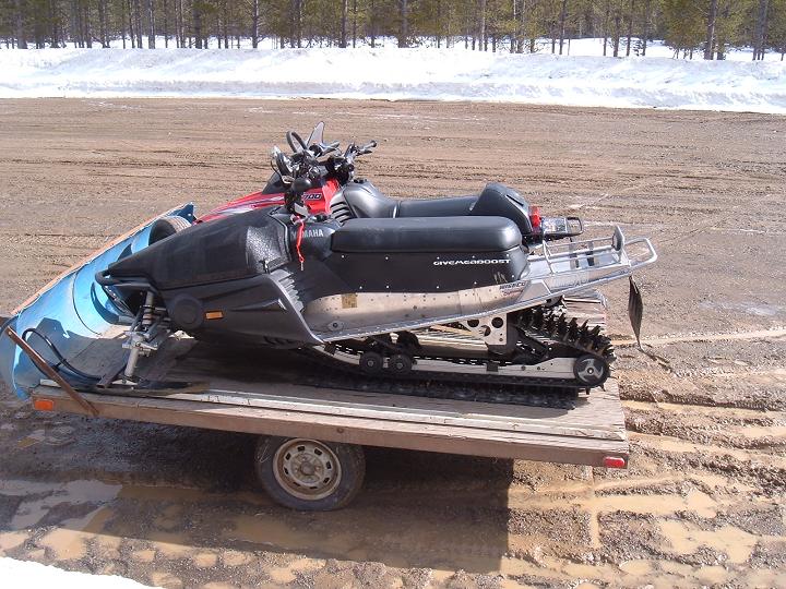

This is how I upped my cooling capacity. I took another heat exchanger and cut it into three pieces and had one welded on each side . Then I took the last piece and ran it across the back and plumbed it in with copper tubing. It took a bit of fabricating but the heating problems went away and it also gave me another foot of room on the running board, Ken.

Thank you for the input, that is a slick sled and an excellent approach. I will propose your approach to a couple of radiator shops - bringing them a new exchanger to cut up and graft to the old ones - and see how they react. Some welding shops get wierd about anything out of the ordinary and others get excited to try something new.
I am also considering leaving the cooling system alone and widening the boards enough so I can stand next to the existing hose, such as Trxster's approach....
