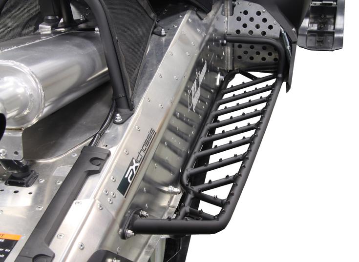

Well, no replies so far. These kind of boards I´m going to install next summer, these are for Nytro:
I´ll install a tunnel/rear heat exchanger to go with this setup. Any of you know can I make the coolant run in the edges of that board?
Maurizio Benelli said:Any of you know can I make the coolant run in the edges of that board?
With enough time and money anything is possible. With the tubular design of those boards I'm sure you can make them water tight. I would concentrate on making only one path for the coolant to flow (outside edge?). With all that criss cross of pipe you would get hot spots.
