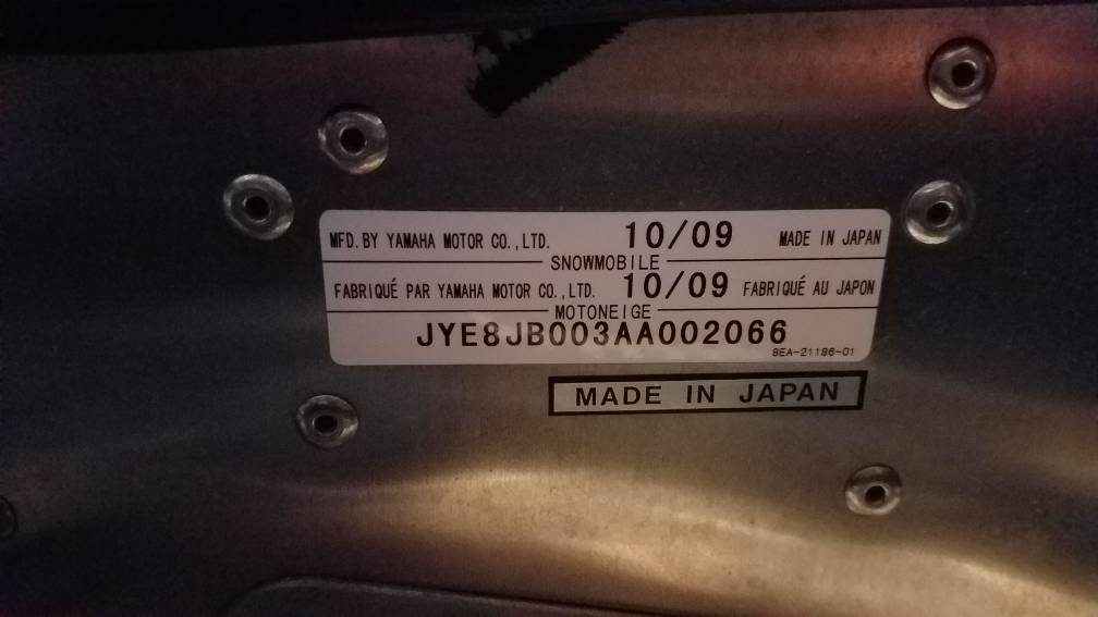

Here's my VIN. Dated '09, but A indicates '10 model.
Something doesn't add up on your sled. Either an engine swap, or it was wrecked, and an '09 tunnel swapped on.
It was originally owned by a Yamaha employee who would have had the ability to purchase units that were not yet available to the public. Where your VIN says AA mine says 9A. Definitely an ‘09.

I completely believe what you say about the VIN.
I am however sticking to my guns that there is something fishy though. Of which I think is a motor swap.
Just because he worked for Yamaha as a whatever he said he was for them, to me anyhow, doesn't make him privy to have essentially a prototype, or own something that's not available to john q public. And prototypes are not numbered/titled/VIN'd either. Again, just my opinion. Please don't take it personal, but I feel the previous owner wasn't honest with you as to why an '09 model has the FI 1049.
Non the less, I'd say you need a kill switch for an '10 since it's been swapped to the FI engine & associated electronics.
