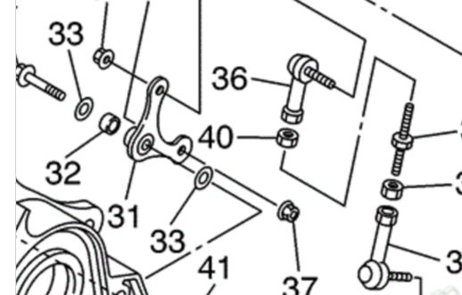

Indy: I'm sure guys will chime in with pics, but for now, check the L shaped pivot arm (#31) that is mounted to the left side of the chaincase. It has a bolt/nut that could have come loose and created slack in the linkage system. Sometimes tightening this pivot arm gets overlooked when re-assembling the chaincase.
The quick answer on the adjustment of the gap between each set of Hime joints, (35+36) it to adjust so they measure 27mm between the ends of the hime joint (aluminum cast housing).

I have had trouble like you with reverse popping out and found #32 bushing in the diagram gets worn and makes it very difficult to get adjusted just right . If you find the bushing loose replace it or see if you can tighten it so adjustment can be set closer as these need to be fairly spot on.
