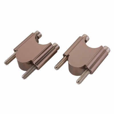

I have had my tusk riser on for 2 days now. It transforms the bike, giving me raptor like ergos. At 3 cm / 1.2 " it feels the perfect height for me. The brake cable is a little tight in right turns as well as the throttle so I may look into replacing these soon but it works. Just couldn't go any higher with the stock cables.
Can't say enough about the change with the riser. At least 5 mph faster through the rolling bumps, easier to correct in the air and no more feeling like I'm going over the bars.

I also want to get a riser. So do you think a 2 inch riser would be to much for the stock cables?
7 skulls
No doubt, 2 inches would be too much for the stock brake cable and the throttle. Replacements for the throttle cable aren't expensive but the brake would involve a whole new line or lines or something custom (raptor line would fit and is 1.5 inches longer) if my research on yfz central is correct.RNL79 said:I also want to get a riser. So do you think a 2 inch riser would be to much for the stock cables?
Before I got the Tusk riser, I wondered if 1.2 inches would be enough. I'm 6 foot and sitting or standing its almost perfect. I got another 1/2 inch from rolling my bars forward and level. Another set of bars could give me more if I needed it down the road.
The tusk riser is cheap ($26); it cost me $56 with shipping. Grip n Rip racing has a nice anti-vibe riser set but it costs $119. Whatever riser you get, there are half moon bar cut-outs at the top of the steering stem, which the tusk fits (see pic). Some risers use adaptor plates and that looks sketchy IMO. Then blue loctite it, let it cure and your ready for a better yfz experience.
