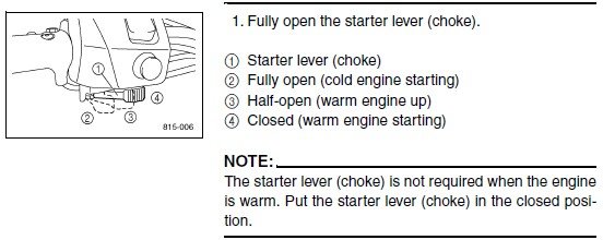

Those low compression numbers don't look good and when you state you burned a whole tank of oil, did you mean the oil tank reservoir you fill when changing oil was empty? The some RX-1's were known to burn oil but more like a quart every 500 miles but keep in mind these aren't two strokes where they are suppose to burn oil. As for cold starting, you are using the choke, correct?

Correct the whole oil reservoir. I am using the choke correctly I would say the hard starting is the very low compression when it is cold. I think it cranks till the rings get hot enough to seat a little better then it fires.Those low compression numbers don't look good and when you state you burned a whole tank of oil, did you mean the oil tank reservoir you fill when changing oil was empty? The some RX-1's were known to burn oil but more like a quart every 500 miles but keep in mind these aren't two strokes where they are suppose to burn oil. As for cold starting, you are using the choke, correct?
