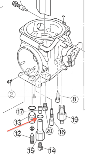

Update:
Runs awesome now!
I set all floats to 13mm and replaced four rubber o-rings on the main jet holders. They were hard. I mean to remove them you had to use a knife to pry them off in pieces.
So the carbs are super clean and setup. It starts and and idles beautifully. I let it idle over five minutes, jumped on it, and took off. No hiccups at all. Wouldn't you know it now I have to sell it. That sucks.
