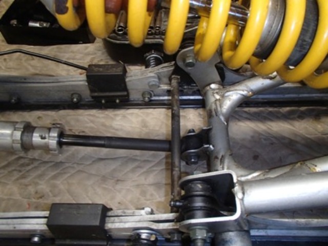

Here is where I mounted my scratchers
vx700xtc
Where is here?Newfie Apex said:Here is where I mounted my scratchers

Hey apex 06....I was thinking of mounting them there also but was worried about drilling a hole thru the side web of the ski.
Thought maybe it would weaken it. How has it been working out for you?

Worked great on my last sled wiith over 5000 miles on them skis. And seem to be doing just fine on this set.

Thanks....I think that's where those puppies are going to go.
