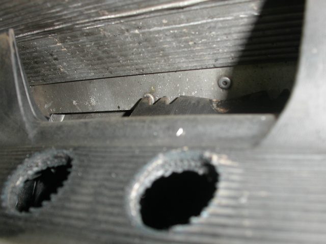

Tundra, my arms aren't long enough to reach much further forward but I think you can see what looks like the track tocuhing the top of the tunnel above the drive shaft. I have Wahl Brothers 7 tooth 3.0" pitch drivers installed.
I may just let the very ends of the tips wear off naturally and not trim anything. I hate to reduce the capability of the track.

Here a pic of the protector with the 2 inch track. I will take a look tomorrow morning to see possibility.
I would suggest you something, youre track is to close front from the tunnel. You should put 3mm thick yamaha washer between the upper shaft of the suspension (front) you will have to pry the tunnel a little bit, but that clear the front bracket better.
And, that bad, but i will wait for the sprokcet, can't find them quicker.

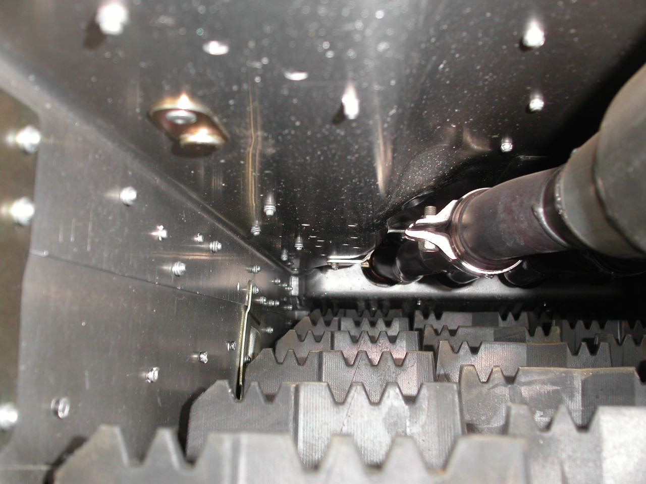

Let me try to get a picture from the front of the sled. It looks like there is clearance from the front but from the rear I can see a few black rub marks on the tunnel cast bulkhead just above the drivers.
It looks like I have a bout 3/8" of clearance between the heat exchanger and the track and I also have 3/8" clearance on the top front of the tunnel. I can't see beyond the front of the drivers so the black marks must be from the track just touching just above and behind the drivers. Maybe it's from braking or letting off the throttle and the track buckles under deceleration?

i guess is does when decelerate, the suspension compress a bit and the track came loose for short amount of time.
Do your hear some rubbing sound when accelerating or when youre steady on the throttle ? did you try on a Jackstand or running on the ground ?
