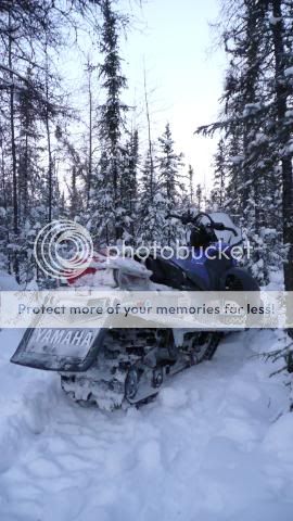

We headed out to cut some trail despite the cold and had quite a few people out there. I didn't get any pics of trail cutting though - I forget I have the camera on me sometimes. I did get a shot of breaking some trail...

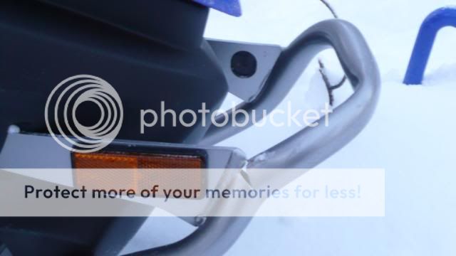

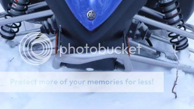

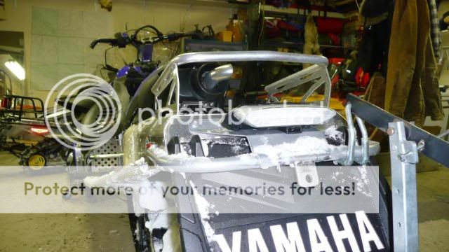

Ah yes, that bent bumper I have from the previous 'tow' gone bad...
I'll be replacing that with a larger bumper that goes with the new floatation plate soon I hope.

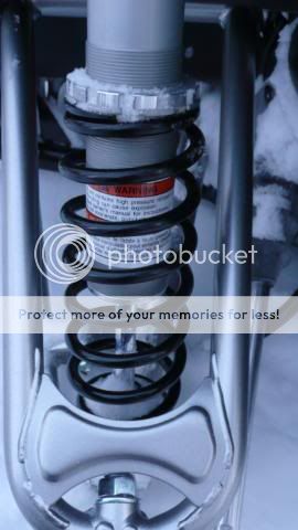

What about that rock I hit? Well I couldn't find any visible damage, except some aligning offset...here's what it should look like (left ski):
And here's what it looks like after side contact with a buried rock (right ski):

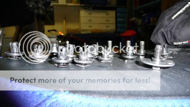

Easy? Yes. Problems? Well...Yamaha uses a lot more plastic to hold things onto the Nytro's, which I don't care for very much. The use a plastic rivet, which can be broken easily when trying to remove them with a flathead screwdriver...I busted a handful of them. The side-under-covers are held on by these plastic rivets, as well as a couple of bolts. I prefer bolts myself.

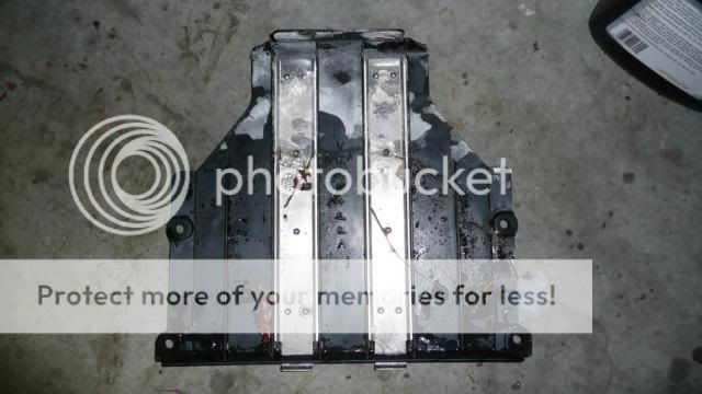

As for the belly pan, it is held on completely by plastic rivets. I was suprised to find that, considering it is such an important piece of hardware...
Belly Pan:
Plastic Rivets and bolt assembly:

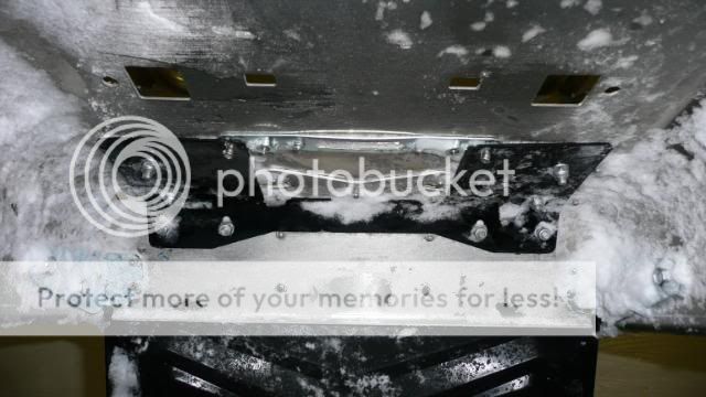

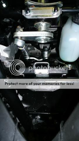

Upon removing the belly pan, here's the mess I had encountered:
That is a lot of snow/ice buildup between the steering column and the belly pan. In fact, that is solid ice that formed from melting snow. Where have we seen this before?

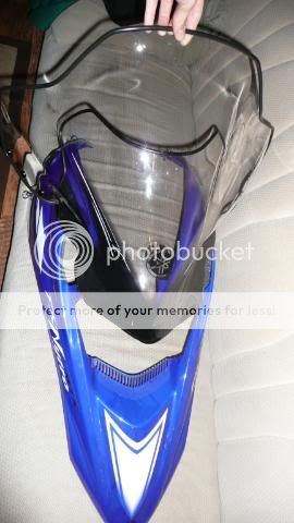

On the nose of the sled, there's a couple of spots snow can get in through the hood, but this is excessive:
This is how it should look:

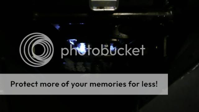

While this picture isn't the greatest, what i've done is put a light below the nose of the sled to show you the gaps where snow piles in, now this is coming from under the sled, not even where the hood meets the cowling...
The picture I showed you earlier of snow between the belly pan and the steering? Much of it is coming in through these holes in the frame:
Those 3 holes above next to the a-arm assembly don't appear to serve a purpose to me. Maybe they do - but there's loads of snow getting in through there!!

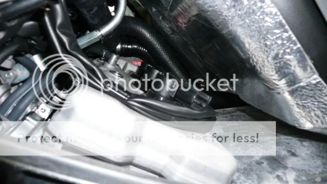

Not that you'd need to get at the plugs much, but there is loads of room to work on this engine:

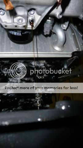

Nothing like the Phazer, you can access things right after taking the cowlings off...and the filter is in a spot where you could fit your arms behind the motor if you wanted...it is located between the front heat exchanger and the motor...
Easy to get at, and easy to drain things...like the crank...
And the oil tank...
Again, nicer to work on...thanks for all that room Yamaha!
Left to right is Allen Head for crank case drain, bolt for oil tank drain, and filler cap for top of motor:
All in all, with a thawed sled, you can get the oil and filter change done in under an hour. It really is easy.
I also took a shot of the huge rad in this puppy, it has a fan behind it...i haven't hand any overheating issues at all, even in low snow conditions, which is sweet, cause the Phazer would overheat in low snow in the spring time, even with the rad/fan...
