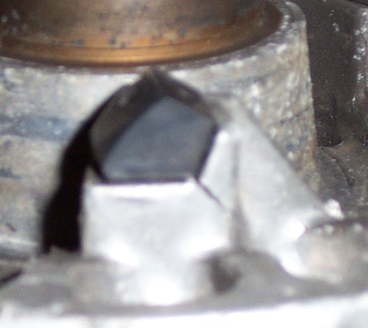

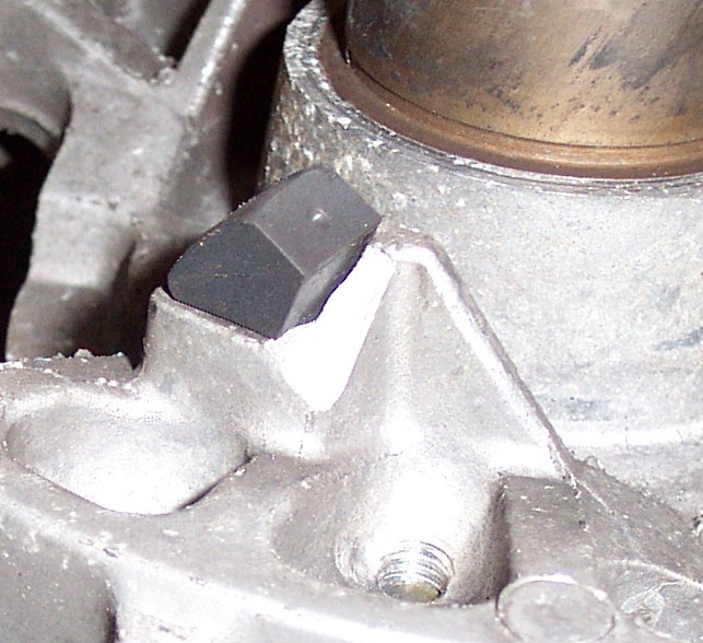

Anyone ever have secondary damage on the aluminum on the backside of the buttons? I was looking my sled over getting ready for asphalt and noticed the aluminum on the back side of each button on the secondary was cracked. I checked the spring which was fine, and clearances without the spring were fine. There wasn't any binding or contact that I could find. I'll have pictures of it this evening.

I believe I noticed this on mine too, but upon further inspection, they apear to be non-threatening. It seems that most of the cast aluminum pieces on these sleds look cracked at first glance, but are structurally sound.

Those are casting marks...no problemo.
monker
no, these are NOT casting marks. I'll get pics when I get home from work.

I wonder if you're overstressing it with the supercharger?
ReX
monker

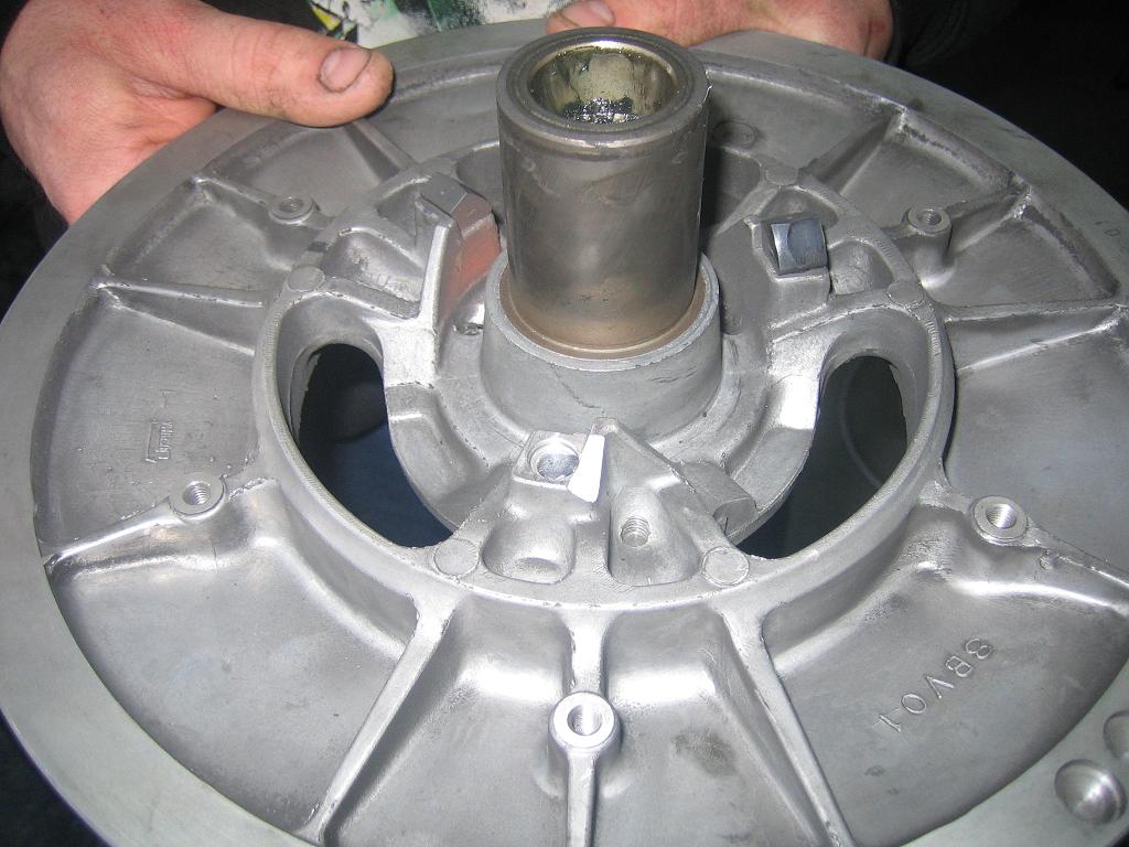

yes! one is busted like that, the other 2 are cracked.

Easy fix. Put a roller conversion on it. It will work better that the buttons too. I would say talk to Maxximum but they are no longer there so try Pioneer and talk to Bruce.

This happened to Neon phil and his buddy Arts secondary's as well.
Call bob At Lightning Pro he can setup you secondary as a roller that uses OEM style helixs.

My guess would be too much HP.

I'm not running anything crazy for hp. Just a supercharger at 7lbs. Lots of turbo guys running big numbers without any problems.
I'm just going to use another stock secondary that I have. What's to say a roller wouldn't be affected in the same way, taking out a bearing or another casting?

My drivetrain is 100% stock but did run an Ulmer Stage 3 clutch kit for a few 1000 miles as well as a set of CR10EK spark plugs for a few 1000 miles more than the clutch kit (part of last season and part of this season).
There are a few other threads on these secondary failures (identical failure).
I noticed the new secondary looks like it has more metal where the old one broke (I didn't measure anything to make sure certain though).

That is DEFINITELY a torque related problem. Blower caused it.
