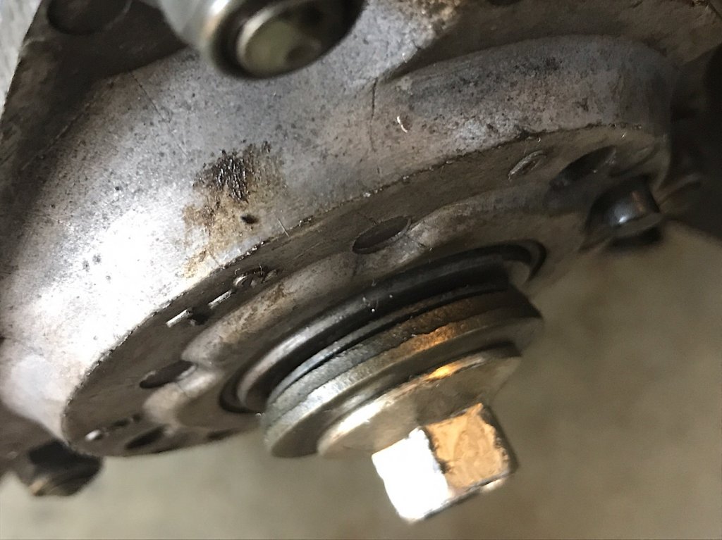

Thanks. I'm pretty sure that's what I have but I'll pull it off and doublecheck. Here's a pic at the bolt. It's the spacer, one shim, washer then bolt. Not two. Could be because an adjustment was done? That's why I need to check play and alignment. I would say I have between 1/8-1/4 of play on shaft.
The secondary floats side to side. Completely normal. The large washer is for the bolt keeping the secondary from falling off the shaft. The thin shims are for setting the offset.Taking note of how you took it off will insure you put it on as it was meant to be.
