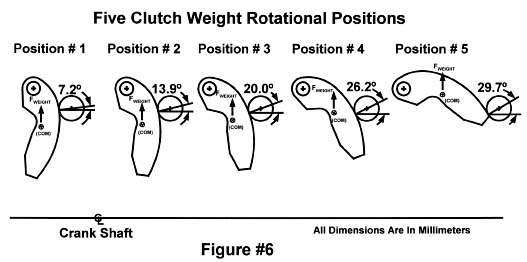

This might help:Still not sure that I understand what black john was talking about
Radial distance to the center of mass (COM)
http://www.sledgear.com/images/figure4.jpg
If you shim the movable sheave away from the spider in the primary clutch (or adjust it with an external adjuster) it increases the contact angle between the roller and the weight. Un-tucking the weight applies additional force on the belt at the lower shift ratios, however, doing so reduces force at the end of the shift curve, which, in most cases, is fine because the weights are generating more than enough centrifugal force at the end of the shift curve.
http://www.sledgear.com/images/figure6.jpg
