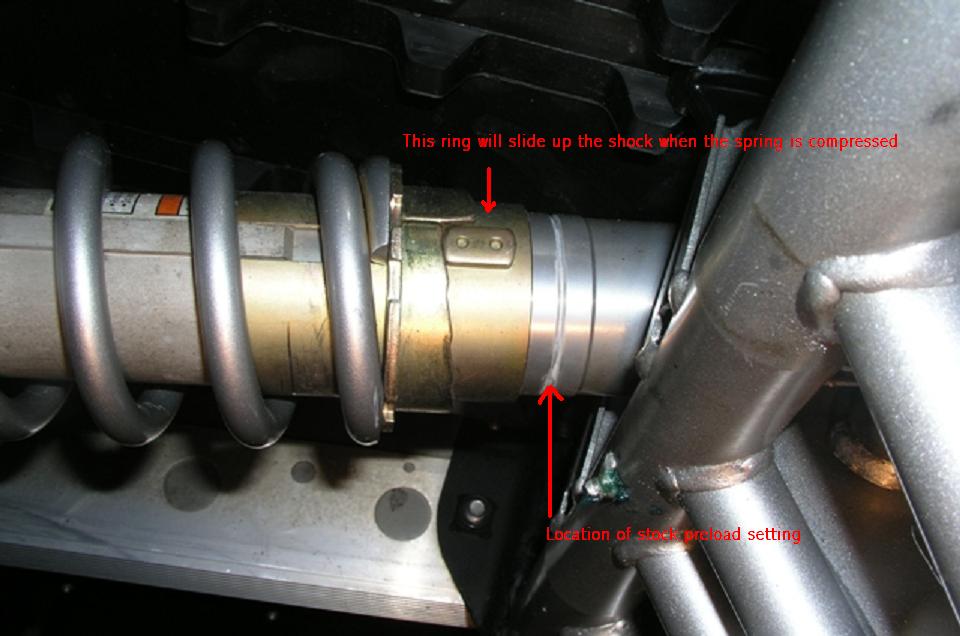

If you have a bearing spreader and some coil spring compressors it can be done on the sled.
It takes about 10-15 minutes on the sled (if you're lucky enough to have the tools) or about 45 minutes to do it by re and re'ing the suspension and unbolting the shock (you still need a spring compressor and you have to make sure you don't damage the shock - most standard spring compressors will damage it if you don't use a bearing spreader or something), followed by checking track tension, etc.
Here is a picture with the tools installed without taking the skid out. In the picture you can see the c-clip & grooves and you can move the clip with just your hand (the clip is in the lowest position (on left) and I'm about to move it to the middle position):
