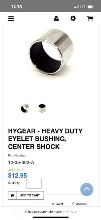

I did change my centre shock lower bushing though as I had quite a bit of play on mine, pretty sure I got it from hygear and supposed to be better than stock.

I use one that's almost like a rubber material on the center shock .lowerI did change my centre shock lower bushing though as I had quite a bit of play on mine, pretty sure I got it from hygear and supposed to be better than stock.

This one works good? My center shaft is destroyed already from premature stock bushing fail.

After the first year on my 20 I switched out the lower shaft with the BOP one and noticed the bushing was loose and worn on the new shaft so I replaced it with the hygear bushing, about 6k on it now and it’s still looking good.This one works good? My center shaft is destroyed already from premature stock bushing fail.
