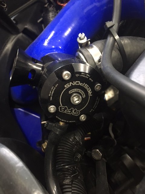

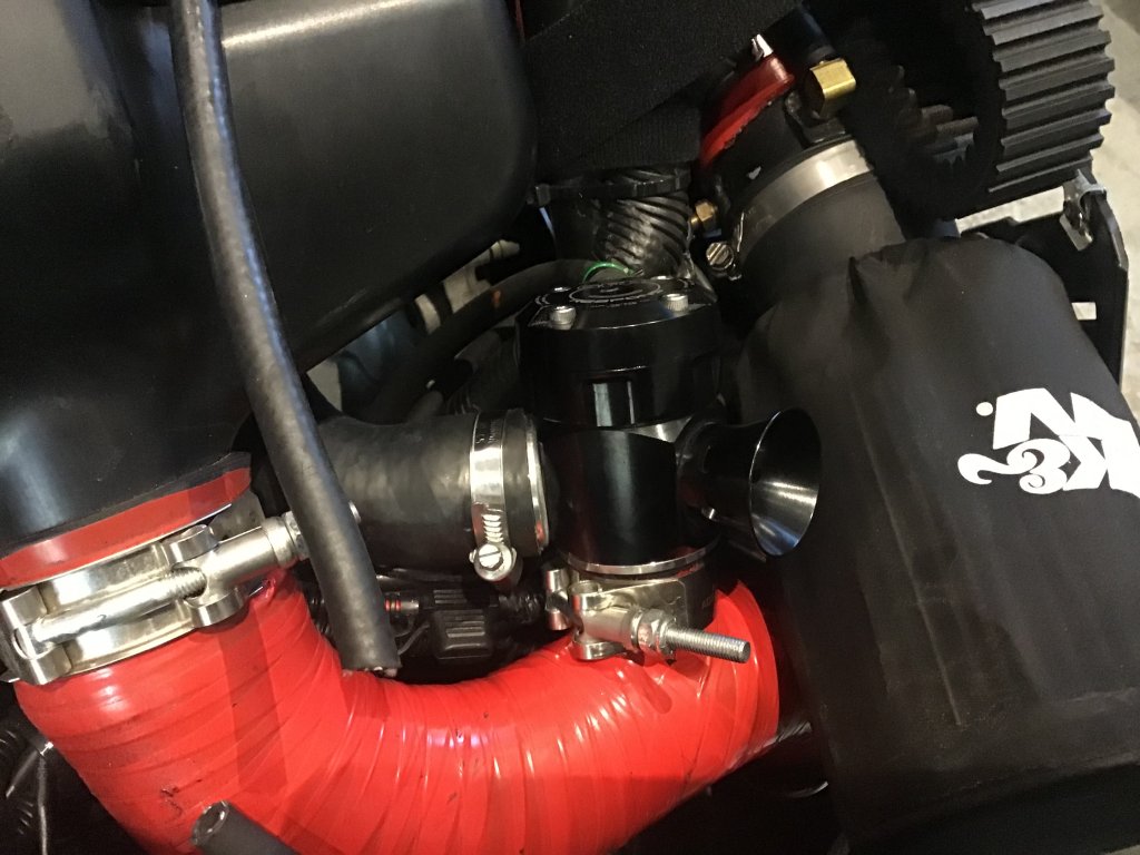

custom
I just installed this one!
GFB respons #T9033. 33mm/33mm
Adjustable to the desired% whitout tool (big ring) . recycling or atmosphere

Will that fit a stock sidewinder without a tune? Or anything needed?I just installed this one!
View attachment 159741 View attachment 159742

it will fit stock winder but i believe if u are not tuned the stock one would be fine, therefore savin ya $ on a part not neededWill that fit a stock sidewinder without a tune? Or anything needed?

What part is adjustable?I just installed this one!
The noise? I love that sound

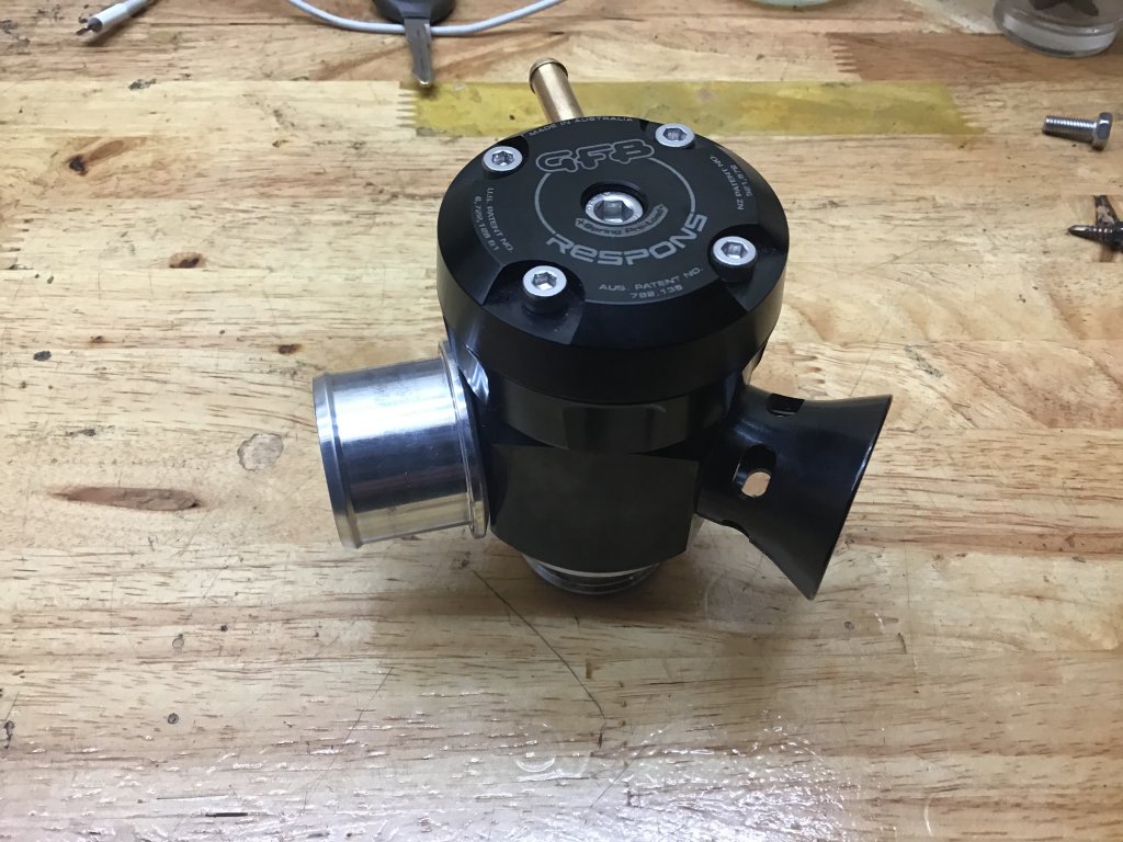

I have this GFB Blow off Valve on my SW.What part is adjustable?
You can adjust how much of the blow off recirculates from zero to 100% and you can also adjust the spring pressure that controls when the blow off valve opens.

Part number?I have this GFB Blow off Valve on my SW.
View attachment 171903View attachment 171904
