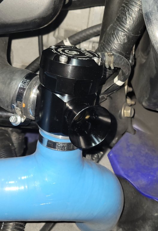

Hey guys, just installed a BFG response BOV on my 2020 sidewinder. I believe I've installed it correctly, it's pretty straight forward. I bought this specifically for the vent to atmosphere blow off noise. The response is adjustable for the noise. I tried it every which way and can't get noise out of it. I adjusted the spring at different settings as well, still nothing. The spring adjustment is really only for the timing of when the air is released but I'll try anything at this point. Anyone have this issue? Any ideas of what is going wrong? My sled has no tune yet and is completely stock. I'd imagine it should still produce bov noise from the trumpet tho.

Hey guys, just installed a BFG response BOV on my 2020 sidewinder. I believe I've installed it correctly, it's pretty straight forward. I bought this specifically for the vent to atmosphere blow off noise. The response is adjustable for the noise. I tried it every which way and can't get noise out of it. I adjusted the spring at different settings as well, still nothing. The spring adjustment is really only for the timing of when the air is released but I'll try anything at this point. Anyone have this issue? Any ideas of what is going wrong? My sled has no tune yet and is completely stock. I'd imagine it should still produce bov noise from the trumpet tho. View attachment 172231[/ATTACH]

Ah OK, I probably won't hear the ch ch ch as mine is stock. I'm sure I'll hear it once a stage 3 is put in for next year. Thx for the reply.I have the under hood intake from TD. I wouldn't say it makes a lot of noise. A light whistle at lower revs and you can only here the ch-ch-ch noise after a quick release of the throttle under full boost.

So I have a PEFI stage 3 and was told can't run a CAI but I wanna hear turbo/BOV noise what do I gotta do lol

Just unhook he hose from the bov so it doesn't make the noise into the intake tube. Point it somewhere else so you can hear it.So I have a PEFI stage 3 and was told can't run a CAI but I wanna hear turbo/BOV noise what do I gotta do lol

Plug port into crossover tube if you do that. Less chance for stuff to get in there.Just unhook he hose from the bov so it doesn't make the noise into the intake tube. Point it somewhere else so you can hear it.
