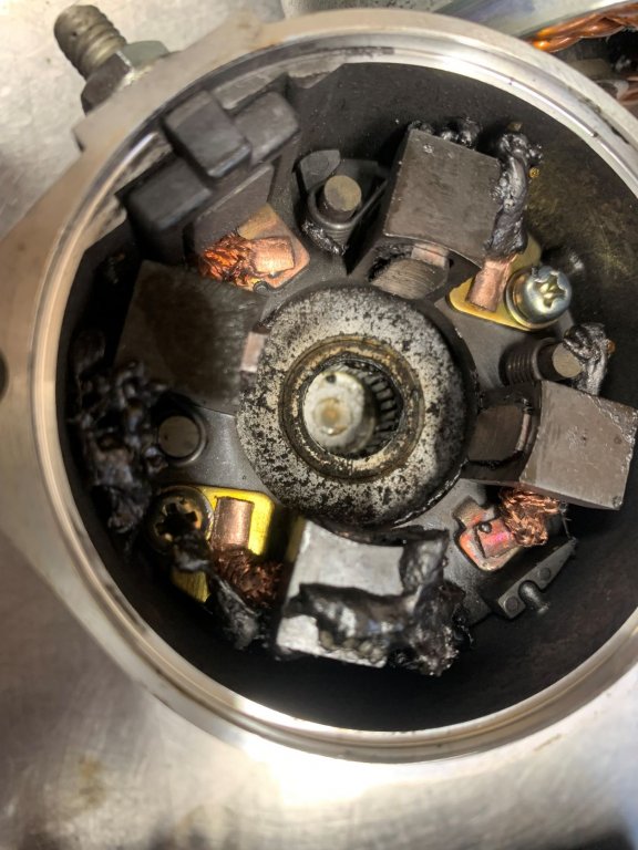

If I read this correctly, the key turns on, but it does not turn over the motor? You only went 10K before it packed it in? My Viper did the same thing and it turned out after filling up and restarting sled, Solenoid stayed on and melted the starter motor. Took about 15 min of riding to do it. Mine threw no codes but the stator would not be happy about the starter pulling so much power.

Thank you InRBigness that is exactly what it was starter is fried just not sure if a bad starter relay was partially the culprit but for 40 bucks a new one will go in. im hoping there was no damage to stator. now just waiting for parts apparently this is happening a lot in thesexparts cause no one has stock lol thanks everyone for input

Glad you found it. I also replaced the solenoid when I did my starter. Its the ONLY thing that can cause it. I have thought about Rocztoyz starter saver LED light. It wont turn off solenoid but will let you know its still powered. Then you could turn off your sled right away and save your starter.
