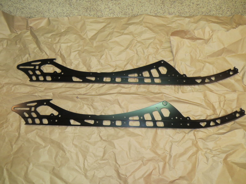

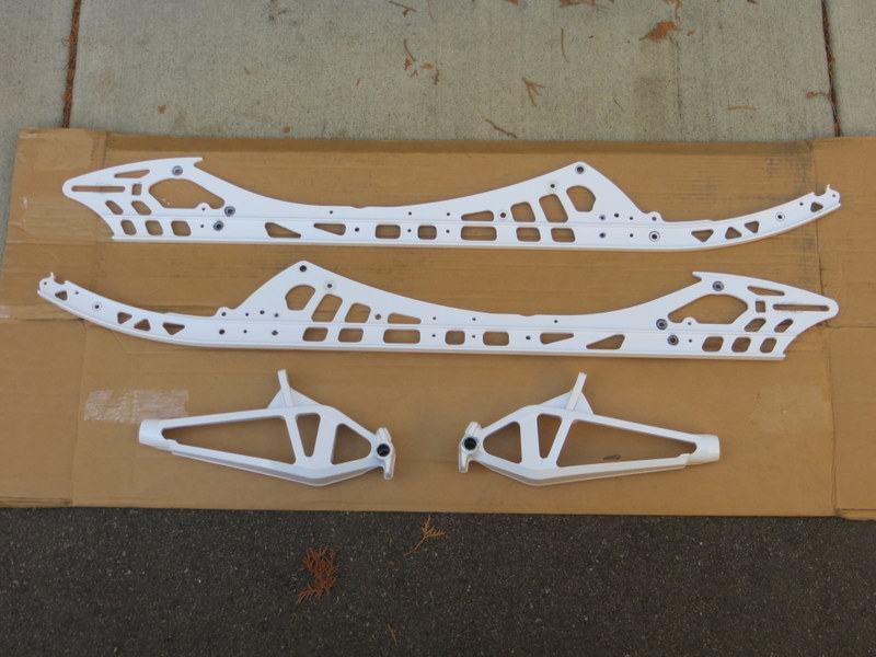

The first things to change were some of the white and red suspension components to gloss black for a cleaner and more aggressive look. I hooked up with Race Coatings in Forest Lake, MN that is owned by Clinton Houle and his shop did a great job on the spindles, a-arms, and skid rails. While powder coated parts aren't exactly the sexiest mods to a sled having the parts done by a professional shop like Race Coatings is worth the long term durability. The finished products turned out to be outstanding without any chipping off this season.

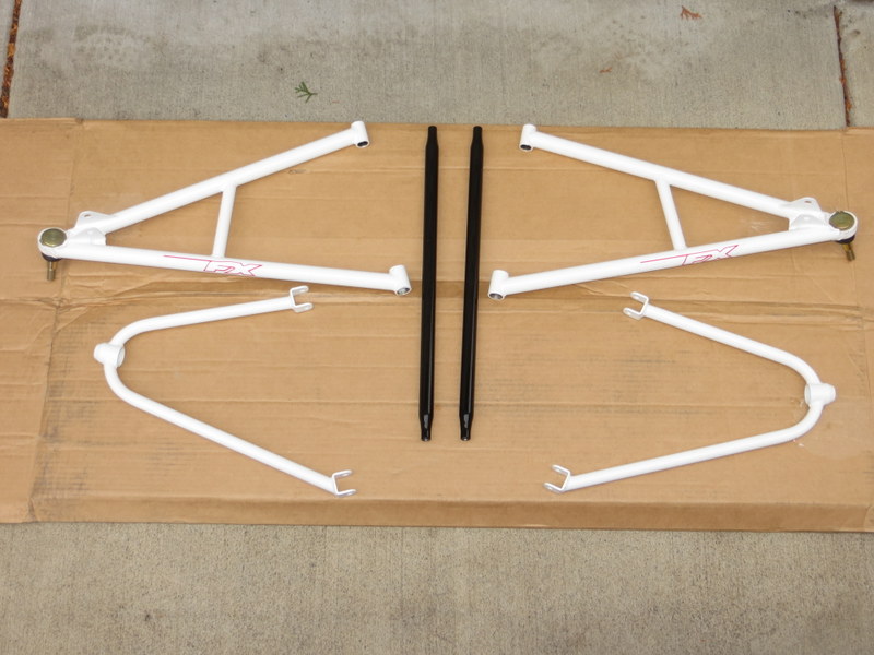

I should mention that I was able to source a new set of Z-Broz 45" wide stance a-arms to increase the ski stance and improve the handling. These a-arms are both stronger and lighter than the stock a-arms. Z-Broz no longer makes these wider a-arms due to lack of interest in the wider stance. They don't come with a sway bar mount, but with my new shock/spring set up the sway bar is not needed and the handling is awesome without the sway bar. I've been super impressed with the added cornering stability and flat cornering with this set up.
Z-Broz a-arms/steering tie rods along with the stock spindles/skid rails before powder coat:
View attachment 127666 View attachment 127667
Parts fully powder coated and ready to install back in sled:
View attachment 127668 View attachment 127669

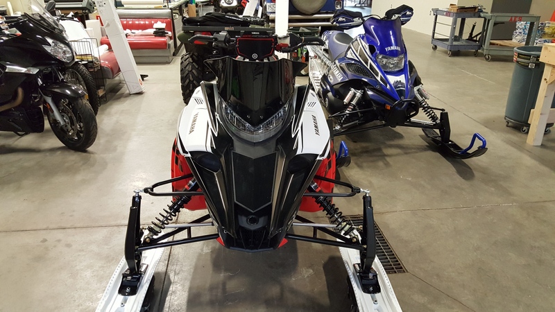

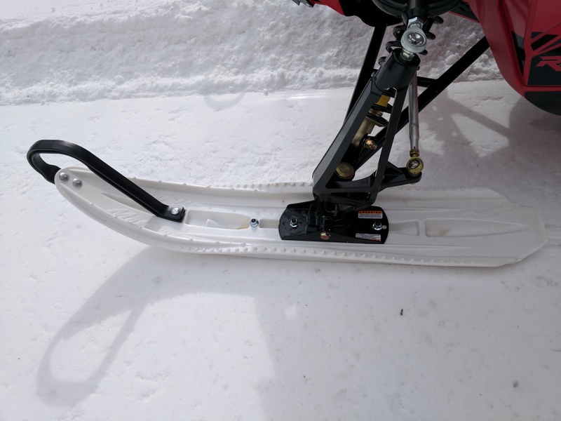

To give the sled some added bite on the front to match the increased traction in the rear along with making sure the sled goes where you point it I installed a set of SLP Mohawk skis. These skis are a perfect match for the rider forward ProCross chassis and once you've got the suspension dialed in for the aggressive skis you've got a sled that will handle and steer regardless of the snow conditions with very light steering effort. With a wider width than the stock skis the Mohawk skis will also keep the front end of the sled on top in deep snow instead of plowing through the snow with the stock skis.

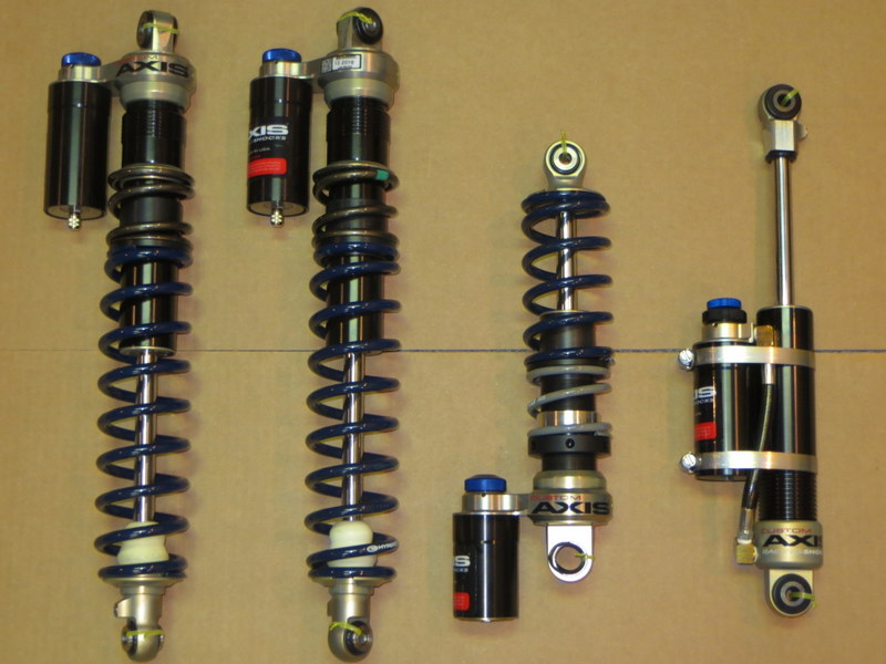

I sold the stock Fox QSR3-R shocks to a fellow TY member (Hi Russ!) and replaced them with a full set of Custom Axis shocks from HyGear Suspension. Ross Benson and his crew did an outstanding job of building these shocks. HyGear custom builds the shocks for your weight so they come delivered set up for you instead of a general rider weight range. The wide range of adjustments on these shocks is great for fine tuning for conditions and the ride is just awesome. I was able to dial in these shocks with very little fine tuning and they offer a very plush ride when things get rough without any signs of fading.

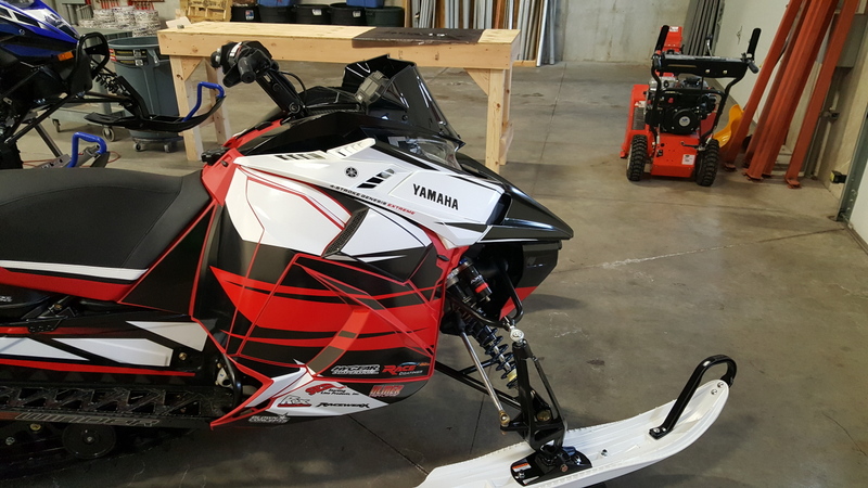

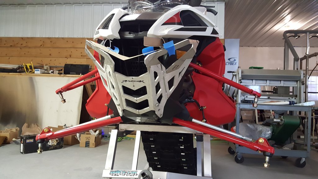

After I got the front/rear suspensions put back together and installed it was time to bring the sled to the Racewerx shop for them to design a bumper for the new SideWinder front clip. Doug Matejcek, the owner of Racewerx is a former Yamaha race mechanic on the Yamaha SnoCross team when Yamaha still had a factory effort in professional SnoCross. He is a true artist and perfectionist when it comes to designing his products and is the only one in the industry who makes laser cut aluminum bumpers instead of tubular bumpers. I found out first hand just how much time and effort it takes to design a bumper for a new platform. I've currently got a pre-production bumper on the sled and the production bumpers will be available for next season. The new Racewerx design has nicely designed hand holds on both sides that easily allow both hands to lift the front of the sled compared to the stock narrow bumper. It also does a nice job of keeping the snow from building up on the intercooler. I really like the overall design and additional protection.
View attachment 127675 View attachment 127685

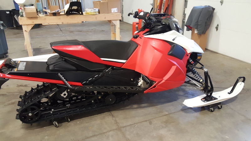

I wanted to give the sled a unique, clean, and aggressive look so I once again hooked up with Robb Kaiser from Blown Concepts to work with on the sled. I've worked with Robb over the years on many sleds from my VX7R custom Viper, SRX, VX1R's and SnoScoot's. He has a unique gift to come up with a look that is clean and tasteful and not in your face. As with the time it took RaceWerx to design their bumper, this new SideWinder platform has a whole new body design with a lot more angles on the hood and side panels than found on the Viper models. I've got a whole new appreciation for the work involved in designing a graphics package on a whole new platform like the SideWinder after working with Robb on this project. There's a lot of template work to make everything come together on this new platform. Here's a few pics of the before and after look:
View attachment 127686 View attachment 127687 View attachment 127688View attachment 127690

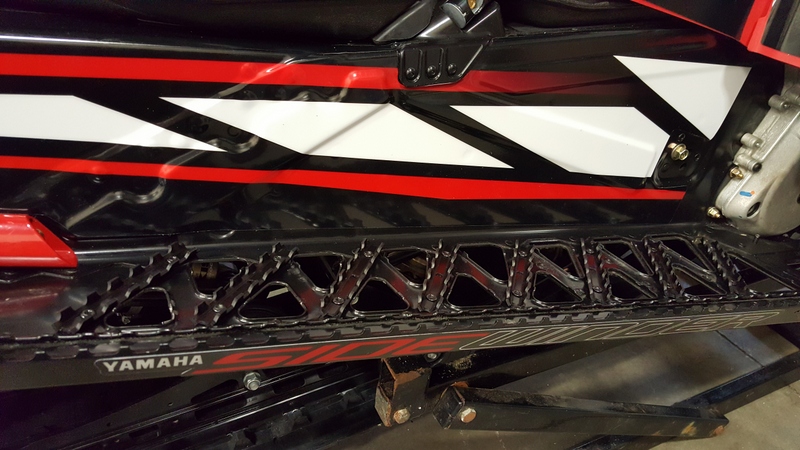

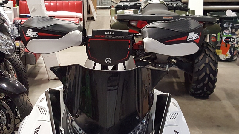

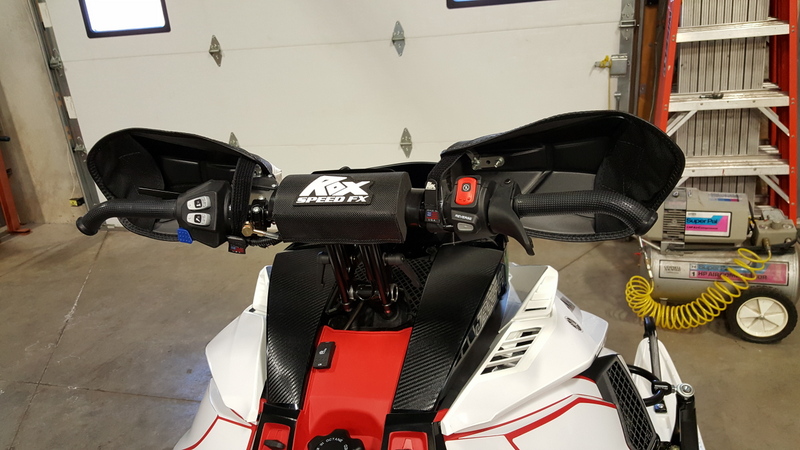

I wanted to make sure that the sled fit me and keep me in control so I contacted RoxSpeed FX. I've got their height adjustable handlebar risers that are super easy to adjust, along with their running board grip strips that really keep my feet locked in place and their Design Your Own Flex Tech Handguards to keep my hands warm and protected. I also replaced the stock plastic handlebar pad with a fully padded Rox pad. Their number plate is a great place to install a trail sticker instead of the windshield:
View attachment 127693 View attachment 127694 View attachment 127695

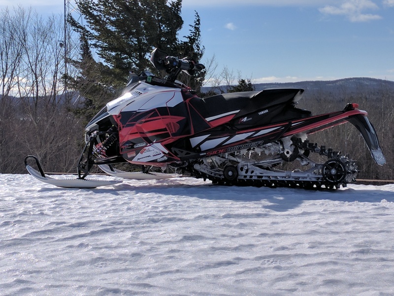

This sled is an absolute thrill to drive and the ride and handling has exceeded all of my expectations. The sled rails through the corners with zero ski lift or body roll and rips through every imaginable trail condition with confidence that I have never experienced before.
I'd like to give a big thanks to Tom aka MrSled and TY for this site. I was able to save a lot of time getting the sled set up by reading other SW owners postings on what works and any potential problems to watch for.

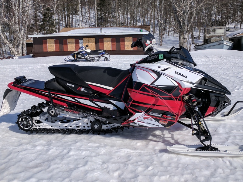

Here's a few pictures of the sled on the snow:
View attachment 128773 View attachment 127696 View attachment 127697View attachment 128404
Happy trails and thanks for looking!

I don't run studs for the simple reasons that we usually ride in good snow conditions and I'm used to riding without studs and adjust my riding style to the conditions, and don't overdrive the conditions. Once I got acclimated to riding without studs and having the sled set up properly my fun factor increased. I love backing into a corner and breaking loose the track and power sliding through the corner. The 1.5" lug Ripsaw 2 track is a perfect match for this sled and my riding style.
