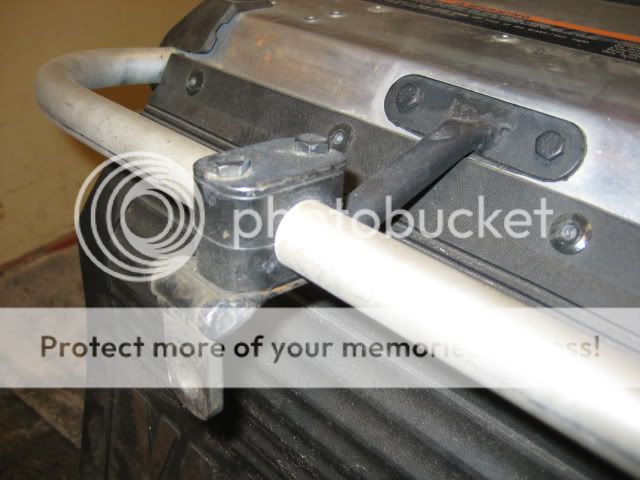

This is one I made and have on both our sleds.
![IMG_0790.jpg](/proxy.php?image=http%3A%2F%2Fi258.photobucket.com%2Falbums%2Fhh276%2Fcanadianhunter2%2FIMG_0790.jpg&hash=5ee0659e77987942948490dbfbf5ddc1)
i used a denniskirk special from a 95 skidoo summit, its a flapper style hitch and is just long enough to tie into tunnel. I do have the stock mtx bumper tho.
