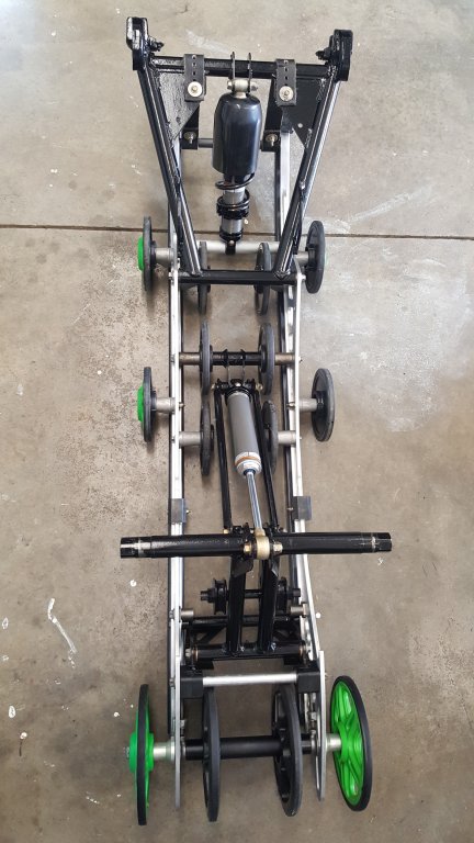

A buddy of mine has them programmed in the Haas CNC mill. He can knock them out real quick. They are made out of 1 x1 " billet aluminum and mine are now clear anodized as well.
If there is a demand for these things, I will leave it up to him to fill the need. He has a 2nd generation fab shop. He owns a Viper and Side Winder and my son and I have 7000's. We have developed the fixes for all the Procross problems.

I am certainly not a hammer head rider. Not after 63 years on this earth. I rarely break things. You can try any track tension and that spot will not stop wearing.As far as adding the small additional idlers, I used to do this many years ago on my own and other peoples sled, but abandoned it for the most part. Those little wheels only stand up for the most gentle riders. Aggressive riders will destroy those wheels in short order.

Hmmm. I don't think I have to upgrade anything. I have 5 axles in the center where all the weight is. Note that the Cat skids have wheels on each side of the shock rocker where Yams don't. This gives me the 5 axles and I didn't have to drill a single hole. I can still add another axle at the rear but there is no slider wear there. If the Wahl wheels don't last the season, I will try adding a pair of real OEM wheels at the curve but there won't be room for more than one axle. Probably on the inside. Got to be careful of the front arm tube and gusset. May have to notch the gusset.
There is only significant wear at the curve, just ahead of the front wheel. By the way, the original Cat wheels are 5.63 inches in diameter and the skid rolls on the floor with the sliders on and does not touch. It always rolls away on me when working on it. BTW, 6004 bearings are junk too so there is nothing new here. Gone are the days of the 6205 bearing that lasted a few years. I re-grease them all every summer.
