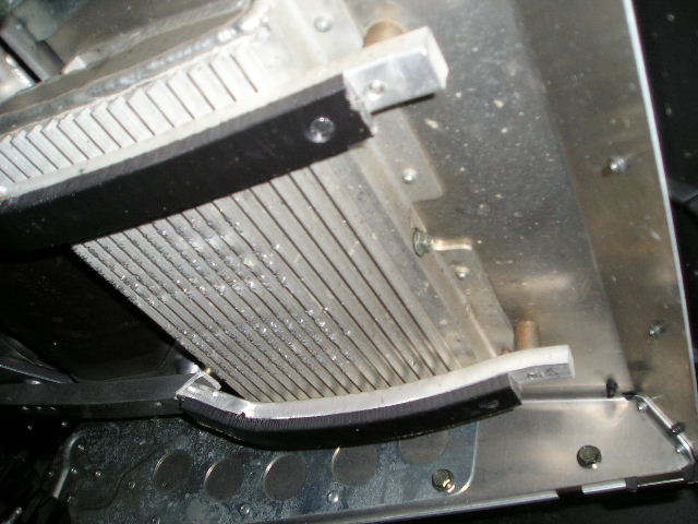

A pic of my (ex) '06 Attak: Dealer installed the steel bars, they weren't tall enough to prevent dinging the heat ex so I did a quick fix to add to it.
