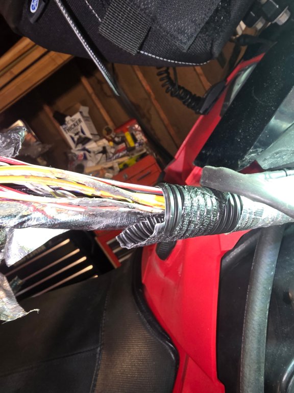

Wire harness that runs down to the chaincase had rubbed thru on header heat shield. Speed sensor wire covering melted and copper was shorting out on heat shield.
White with orange wire for speed sensor.

I noticed yesterday my harness was touching the exhaust heat shield in the same area. Looks like it was starting to melt the covering. Tried to reposition and secure it. When I put the side panel on it pushes it in a little. Gonna try and get some heat wrap and cover that areaWire harness that runs down to the chaincase had rubbed thru on header heat shield. Speed sensor wire covering melted and copper was shorting out on heat shield.
I Put a piece of firewall heat insulation on top of the heat shield where the harness is.
Might have to find some of the orange heat hose they used on the exhaust evap system on the automotive side.
I found with the rollover valve bypass, O2 sensor wiring, and misc added wiring all running up beside the exhaust heatshield it is difficult to keep everything a safe distance from the heat especially after you reinstall the side panel. I was very fussy about the routing of everything close to the exhaust and check it regularly to try to avoid heat damage. Even still my flasher ended with its case being melted a bit but fortunately still works fine.I noticed yesterday my harness was touching the exhaust heat shield in the same area. Looks like it was starting to melt the covering. Tried to reposition and secure it. When I put the side panel on it pushes it in a little. Gonna try and get some heat wrap and cover that area

This looked like it was starting to melt the covering also. After I peeled it apart is when I found the covering on the wires melted also.
Definitely an area of concern to watch.
