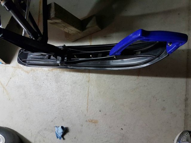

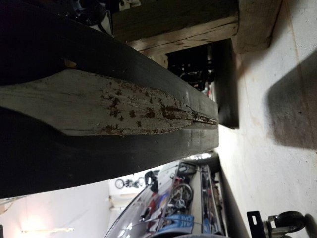

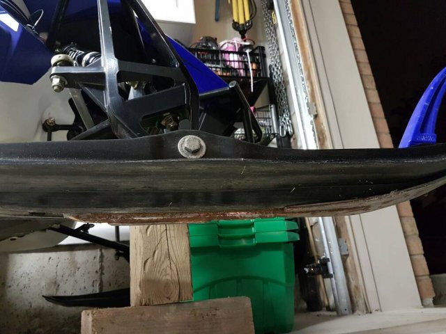

It has some sort of carbide on there. I'll have a look to see if I can figure out what they are. I ride mostly trails in bancroft area.

Gannoochi
- Sep 10, 2016
- 63
- Miss
- 14 viper ltx
This is what's on there now. Not sure what they are.
