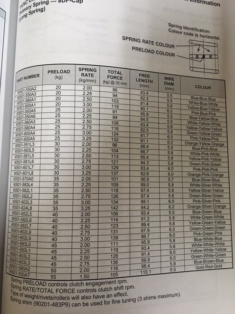

Anyone know what the Barn of parts "soft start" spring rates are? start and finish rates compared to the stock viper spring? Thinking about getting one as long as it has a final rate of the stock viper spring.... I have never seen them posted .
Rich Kay
Ya..... I have that info too cannondale but have never seen anyone claim or post the barn of parts soft start spring rate specs ? makes me want to invest in a spring rate tool....
Well Travis figured it out so he deserves the sales.
Rich Kay
For sure! was going to order one for sure from him, just looking to know the final rate so that would not mess up my clutching at full shift.Well Travis figured it out so he deserves the sales.
