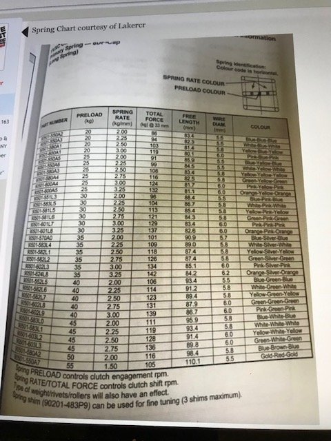

Here’s some charts to help you decide on Primary Springs if you do go there!
Yamaha chart has 3 colors, yours being the last one on the bottom of that page!
Gold-Red-Gold
Gold-Red-Gold
Gold-Red-Gold
Thanks, Motorhead
