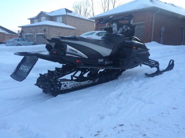

Looks good!! I did the exact same kit you did, except i got my tunnel extension powder coated black to match my black tunnel. How did you like removing the structural rivets from the track adjuster brackets?! What a job that was! Something for you to consider also for slider wear... run your dupontes backwards so the inserts run along the tip up. I did on mine and my sliders are wearing beautifully. I also added an extra set of wheels where you did which also helped. I did not add a shaft as steiner mentioned, but maybe not a bad idea. I ride my sled hard and luckily have not had any issues with cracked skid rails.

Food for thought.... I am not sure what you've got for a rear heat exchanger or if you have one at all, but I had to relocate mine into the tunnel extension as my 1.75" track would slap it when my suspension would fully compress. It actually pulled the rivets through the mounting brackets on the exchanger and popped the left side flex hose off the side exchanger dropping my coolant on the trail!! TWICE!! Although my 1.75" track clears the tunnel no problem, it would still tag my exchanger if i came in hot into a sucker hole ... you could see approx 1/4" black marks on it from my track! To ensure it didn't happen again, I made up some aluminium brackets to mount the exchanger on the bottom my tunnel extension. I had to cut and re weld the pipes going into the exchanger so the overall width was narrow enough to fit inside the extension because in stock form, it exits out each side of the tunnel. I then got some stainless tubing mandrel bent to run through the tunnel and re-attach to the side exchangers with the OEM flex hoses. Kind of hard to describe in words, check out my pics. You can see my exchanger was tweaked a bit from when my track hit it, but i had it leak tested and it's all good!
