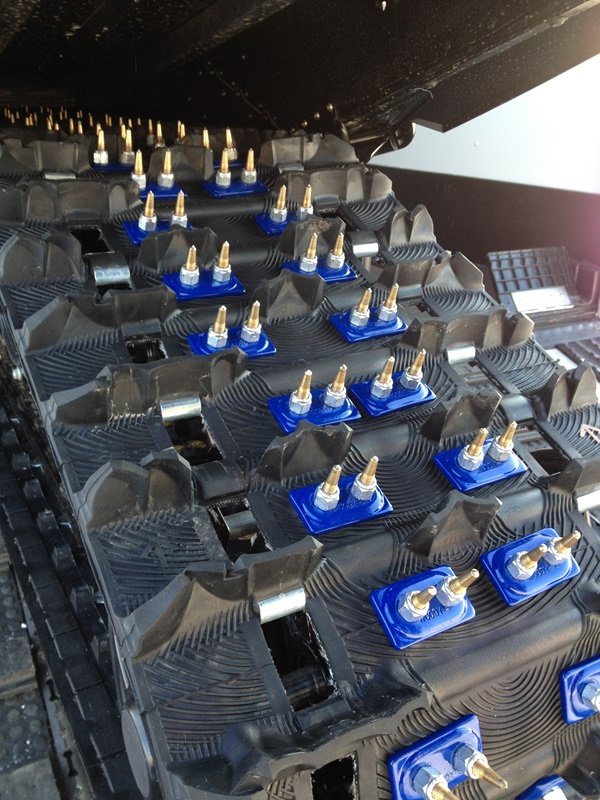

Those studs should grip in the grass too
Blu2U2
RTX Meirda
Any tricks to getting them nice and straight?

Blu2U2 said:Here is a picture of mine. 2 Woody's doubles per row with 1.325 Gold Diggers...
oooh... that looks nice. So does your avatar... in fact, i think I made that image last year after the release. Is that where ya got it from? (I know you ended up with the real thing, super jealous)
sk-rx1
Any issues installing the studs over the "quiet" bumps on the inside of the track? If you try to avoid them you only have about 4 1/4 inches to work with at the center of the track.
Blu2U2
DigitalFusion said:Blu2U2 said:Here is a picture of mine. 2 Woody's doubles per row with 1.325 Gold Diggers...
Thanks and yes I did get the avatar from your post. I hope you didn't have any copyright laws on it....
Blu2U2
sk-rx1 said:Any issues installing the studs over the "quiet" bumps on the inside of the track? If you try to avoid them you only have about 4 1/4 inches to work with at the center of the track.
As long as you use the tall nuts all is good. Last year I had fits with the Stud Boy all in one plastic backers and nuts since the stud threads would strip out the backer/nut when the stud head was not flush with the track on the "bumps" of my 13 AC SP Turbo.

Blu2U2 said:Thanks and yes I did get the avatar from your post. I hope you didn't have any copyright laws on it....![]()
ha! no, I just was commenting on it, and realized it seemed the right proportions to be the one I made.
09nytro
That's good to know , I was thinking about shaving down the bumps but if I don't have to then I'm not !Blu2U2 said:sk-rx1 said:Any issues installing the studs over the "quiet" bumps on the inside of the track? If you try to avoid them you only have about 4 1/4 inches to work with at the center of the track.
