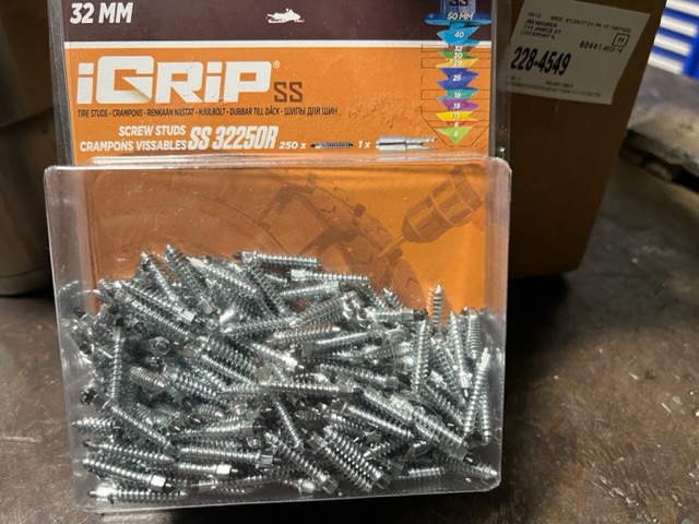

I put the 32’s in my 18 XTX SE 137 that has the 1.75 backcountry track. The pics above are the IGrips I used and also the pattern. Pre drill and use some dish soap on the threads. Made a huge difference in traction. I’m not a fan of using studs on a single ply track.
Go on IGrips website and it tells you which stud to use. I can’t remember where I found that pattern. It was on some random site that I happened to stumble across searching. Had a few different tracks as well. If I can find it I’ll post a link.

I put 256 in a 1.75 Hurricane track. Some 32s, some 28s. Some of the track paddle locations dictate which. Thing hooks great in general trail riding conditions. I dont go to the local ice drags anymore, so dont need the "Cat on a screen door" type of traction anymore.

These IGrips have been in for 2 years and none have come loose and still look great.
