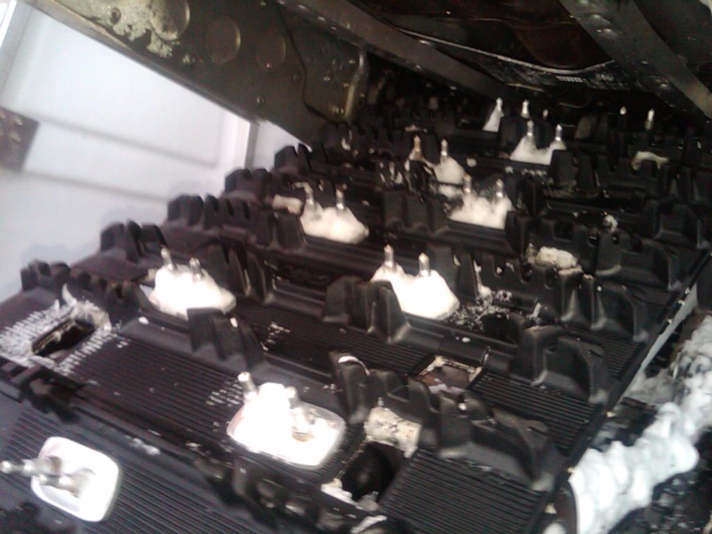

I wouldn't leave a bar open ,My riding buddy has the exact sled as you with two sets of doubles on every second bar and it sounds/feels like your riding a freakin freight train on hard packed ,I think it has bad balance when it come over the drive wheels with more weight on every second bar.Here's a pic of mine with 10000k ,6000k with these studs.
