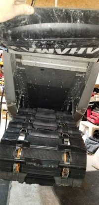

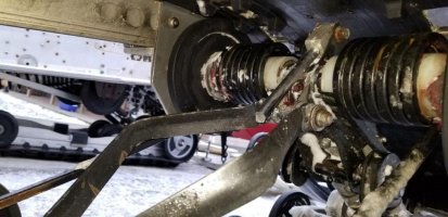

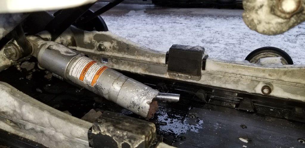

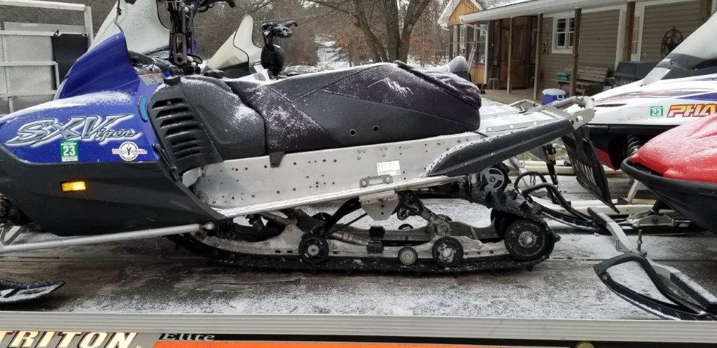

And here are some pics of why (the bad) . . .

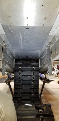

And now the good
