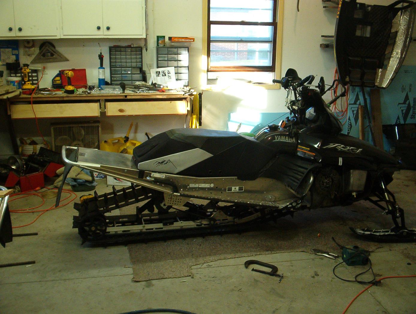

Almost done!
Got some more work done on it... now just need the tie rods from timbersleds (sent wrong size w/ the kit) and a throttle cable extender, and can get it buttoned up!
Summary of changes:
* under tunnel exhaust
* Hartman extension
* BOSS seat
* M7 153 skid (anti stab wheels), used VanAmburg drop brackets and Fabcraft wheels
* 162 x 15 Challenger track (3" pitch Avid drivers)
* wildchild rider forward (with another 2" riser)
* Barkbuster front end w/ fox floats
* Hartman clutching w/ TEAM secondary
Now I just need to sell my first born and then for it to be 12/18 for my trip to Cooke!
Nomad

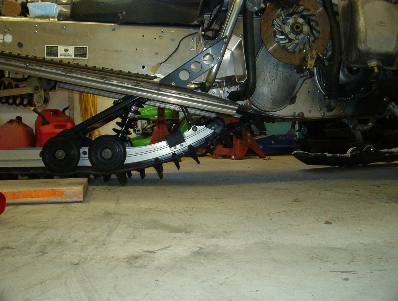

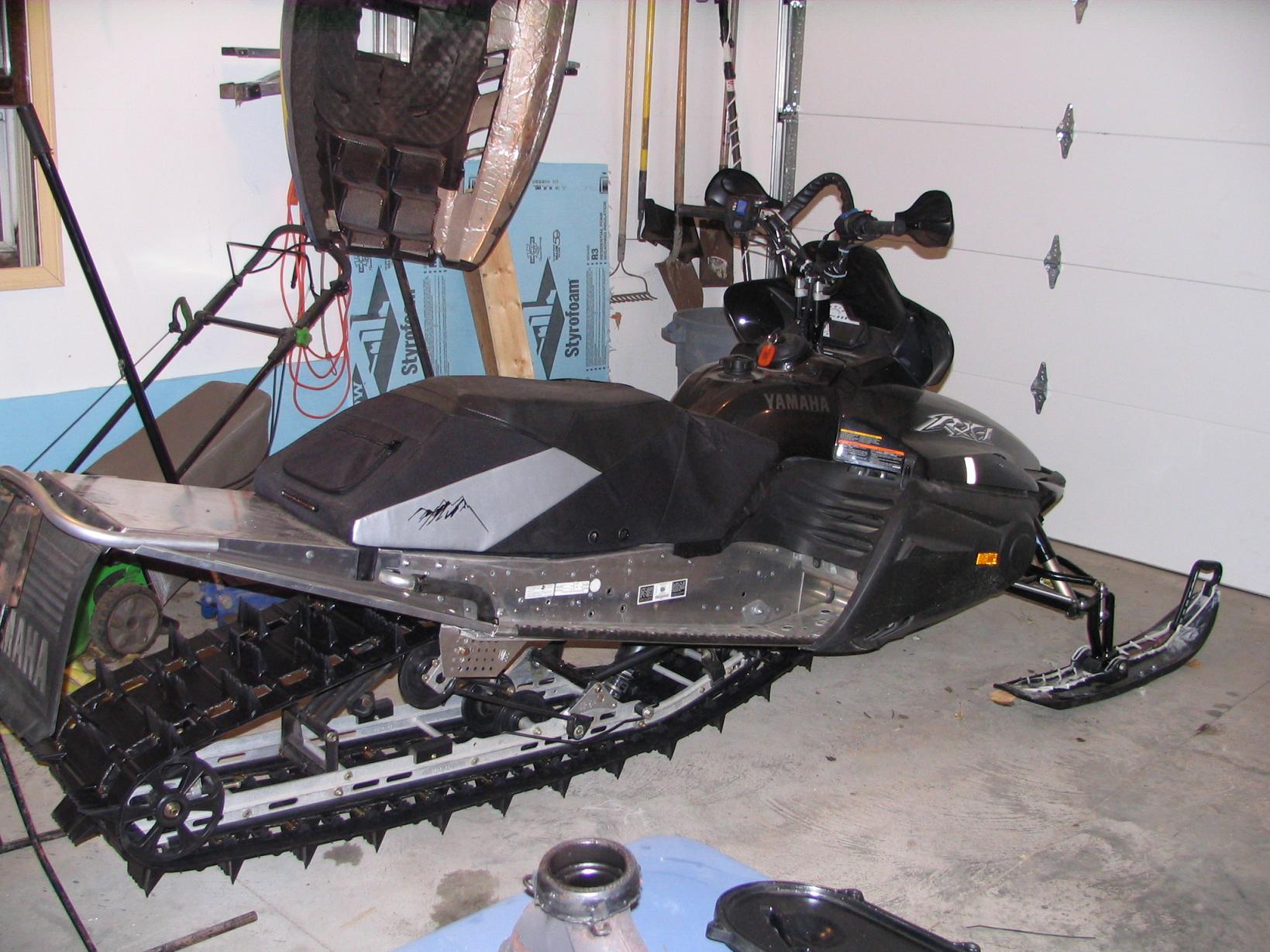

Well, the last bit of work on the 3/4 ton (down from a 1 ton) was done by my buddy BIGGDAWG last night and he sent me pics. All in all, I think I'm down 90+ pounds from stock. Now just can't wait to get it in some powder/on some hills and see what it does!
Nomad
