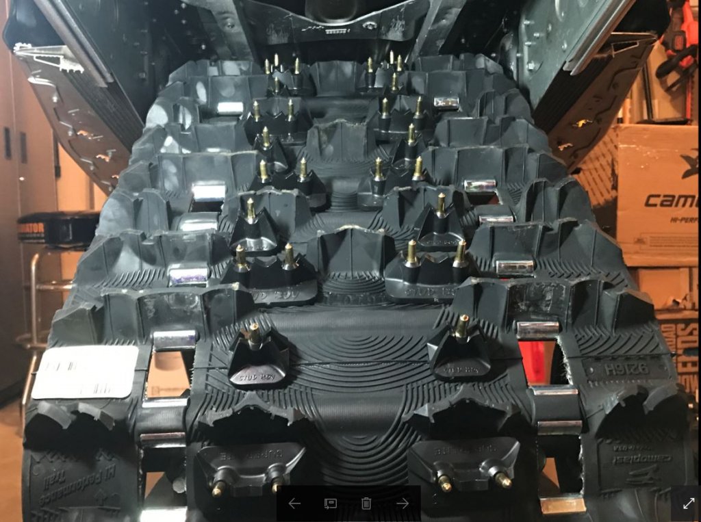

Have run them with 1.45" MegaBites on the turbo 1200 for over 6000 miles and never replaced one. Putting them on my 280 HP Sidewinder too.
I like to tap them half way thru or so before install as it prevents them from stripping out and seems to have extra holding power. Takes about 2-3 minutes to do 48 doubles with a tap and a reversible drill. I love them in a 1.25" track and the extra traction they provide.
Here's a pic of 144 I ran on my 1200 Doo.
