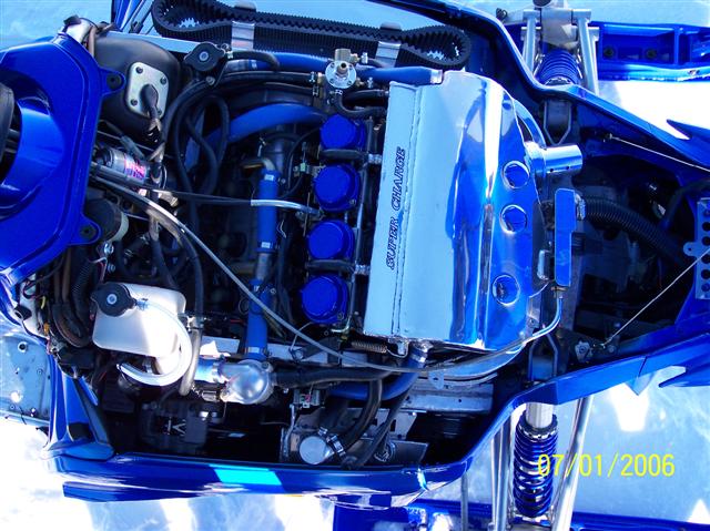

Well, a supercharger will make 3 psi at clutch engagement with no boost threshold (LAG) and 7 PSI or 10 PSI with a Stage I kit so fast the turbo hasn't even thought about it yet, unless of course you use the NOS crutch but now you have two systems to maintain and to be fair it's the NOS THAT MOVED THE SLED NOT THE TURBO.
You do have some power loss with a turbo in the way of back pressure but in all fairness again cams can be moved around to minimize the loss.
Fuel requirements are the same for both turbo and high efficiency superchargers like the MPI Rotrex, boost is boost the motor doesn't have any way of knowing one from the other.
Please keep in mind I'm a non-bias guy that loves all kinds of forced induction. Just want everyone to know they have a choice.
I don't recomend anything over 10 lbs. of boost either way with pump gas on a stock motor. If you like to hold it long I'd drop that to 7 pis, Engines are too expensive and take too long to change!
As soon as I get a chance I'll have some real dyno numbers to post for all to see.

MPI says stage 1 for a rx1 230HP @10lbs 50/50 race gas and 200HP @ 7lbs on premium fuel
www.MOUNTAINPERFORMANCE.con
is this right and possible ??
BlueMax
- Feb 18, 2006
- 82
- 366
Bum7272 said:MPI says stage 1 for a rx1 230HP @10lbs 50/50 race gas and 200HP @ 7lbs on premium fuel
The MPI dyno chart shows 230 corrected horsepower for 10 lbs boost. I kind of side with Ted and wonder what the HP loss is for the supercharger belt drive. MPI states in their FAQ section that there is as much as 10 HP loss to drive supercharger. With no losses, you can barely get 230 HP from a stock 137.5 HP engine. The numbers will be within 10 HP of those published numbers.
