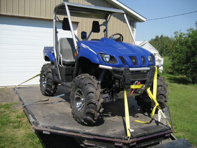

Anybody have a supercharger kit from MPI yet? I've got one comming for my Rhino, its supposed to frickin rock! I'm told @ 10#'s of boost it will take my Grizz with its Hauck 800 stroker kit! MPI only has the kit for the Rhino but the boys @ Red Deer Powersports are working to modify it onto a Grizz... should be sweet.

Well.... had her out on the weekend and she roots pretty good! I had a few small issues with the jetting and throttle chop, a blow-off valve should eliminate the throttle chop. It wasn't building as much boost as it should due to the 30" tires,but I've got another pulley coming to bring it up closer to 12 #'s of boost. The 6" Gorilla lift looks and works wicked!
Should get another ride in next week, hopefully.....

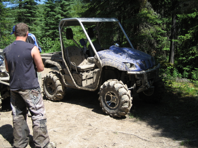

It worked pretty good all last year, a couple of problems, as with anything new. Depending on your riding terrain you will want a spare belt for the blower. I basically like to ride in lots of mud so the belt kinda takes a shet kickin. They're cheap and only takes you a few minutes to change them.
I'm finally putting a blow off valve on this week, that should help out with the flooding issue or "throttle chop"
I'm also trying some smaller tires, not that it can't handle the 30's but it might get a better jump out of the hole. Those 30's seem like they might be tough on drive line stuff, not to mention the work to steer the thing. Here's hoping to get some power steering! I've got 27" swamp lites on it now so we'll see how they work.
