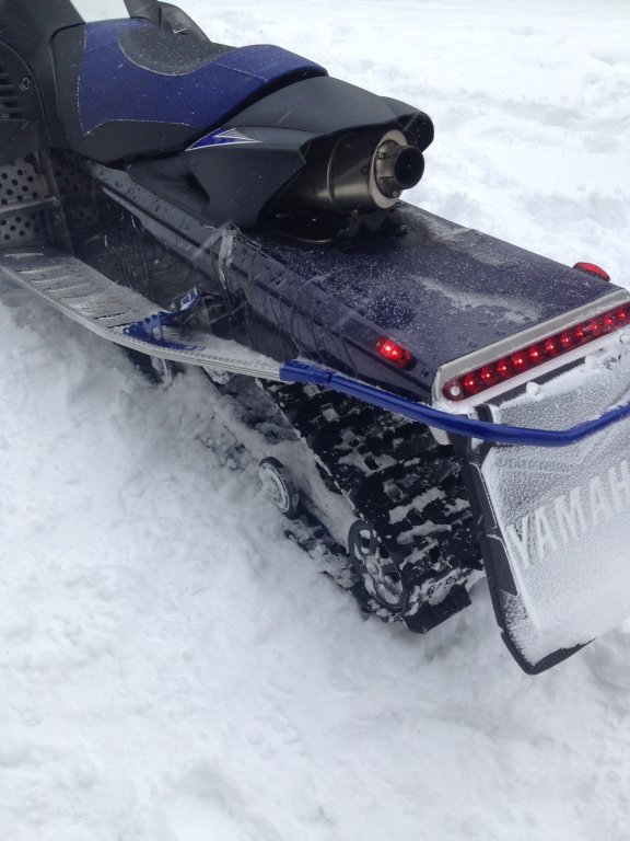

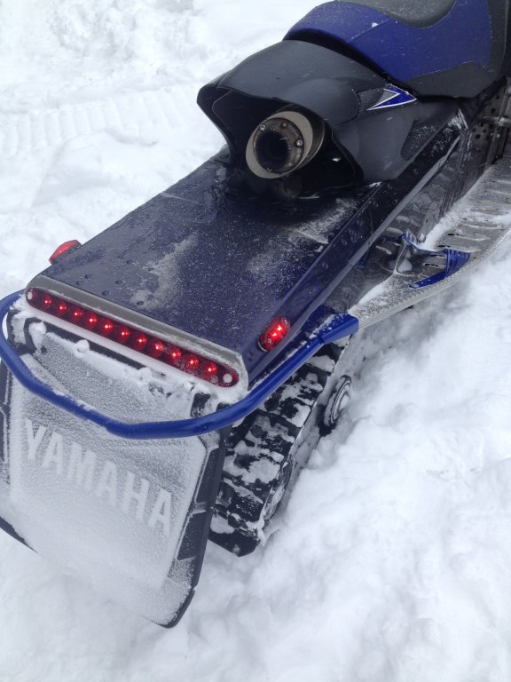

search tail light fixes maybe.. Myself iput a red light bar across back of tunnel. sorry have no pics.

DSimps10 has a pic. mine the same but red
. can find it under tail light relocate

I found my block off plate in the tunnel significantly reduces the degree it gets covered with snow and ice. But in the end it still gets coated.

Mines the same as Tod
- 8,047
- 2,135
looks like the one on the rear of my 2013 united enclosed trailer. brother ran one like it on his 2004 rx war mod and it survived his wreck of that sled.
greekman133
I have the same as todd takes about an an hour to do and you will kick yourself for not doing it sooner ad to that an exhaust turn out and I mount a 2gal kloppin (blue one matches well) tank and a tool box on the back and have storage and range to boot

My SB block off plate did the same, no complaints after I installed it... Some dusting only in snowy conditions.I found my block off plate in the tunnel significantly reduces the degree it gets covered with snow and ice. But in the end it still gets coated.
