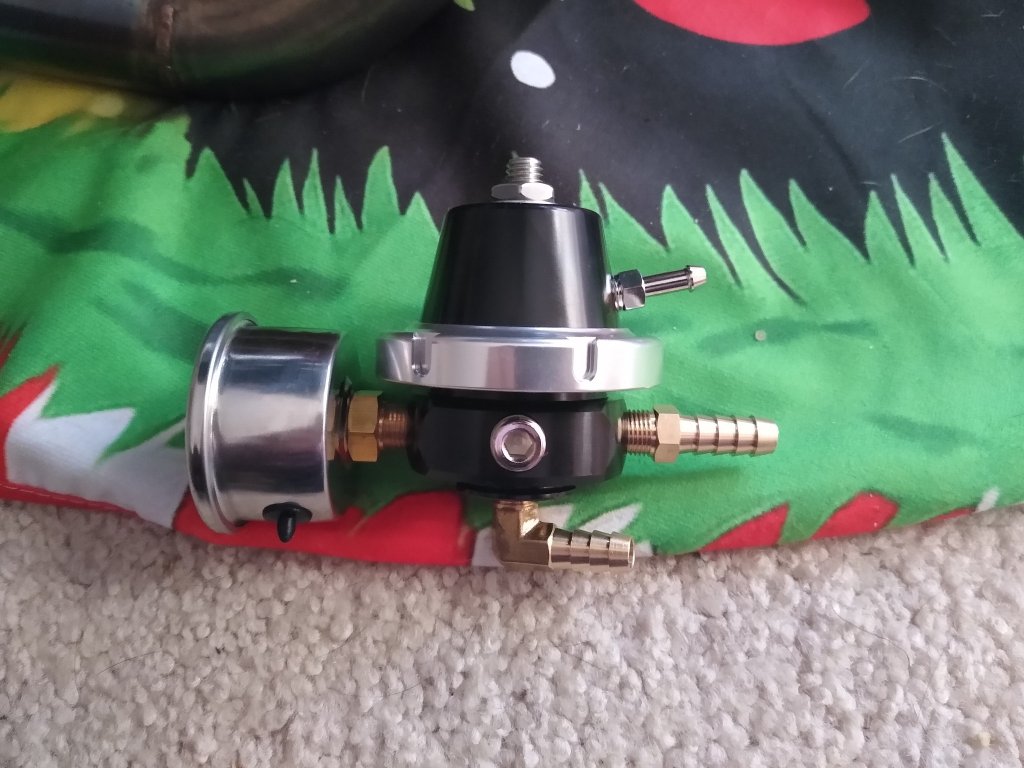

What is required to seal these fittings?

I use locktite thread sealant with ptfe in the bottle with brush.What is required to seal these fittings?

Got a bottle of that....down in Florida. Lol.I use locktite thread sealant with ptfe in the bottle with brush.

Agree. PTFE thread sealant.
