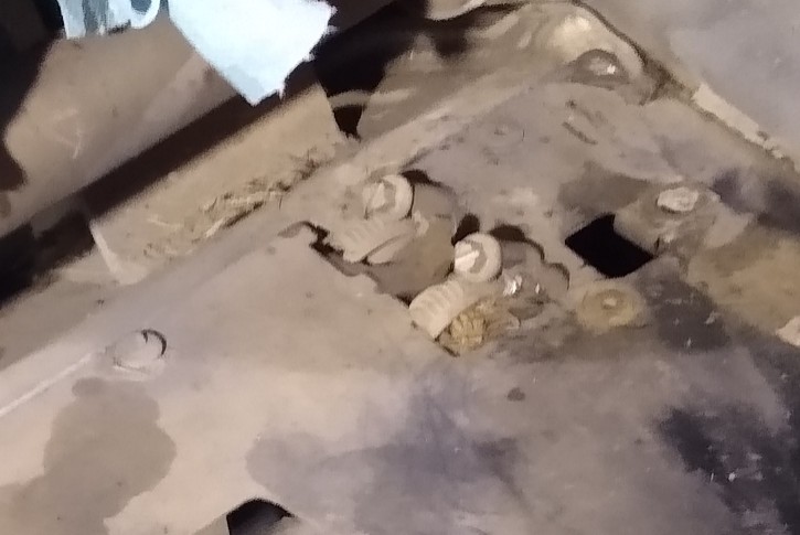

I suppose I'll clean this up and throw a little cover over this hose, make sure the clamps are tight?
Fatchance, yes I've got a heat gun and understand. Ty

Yup. That hose & clamps has been the source of many problems over the years. Definitely take care of it. PIA to work on.Ok, well...this will take longer than I thought. Ty for all the tips, I'll get as much done as possible. Better to be on the safe side.
