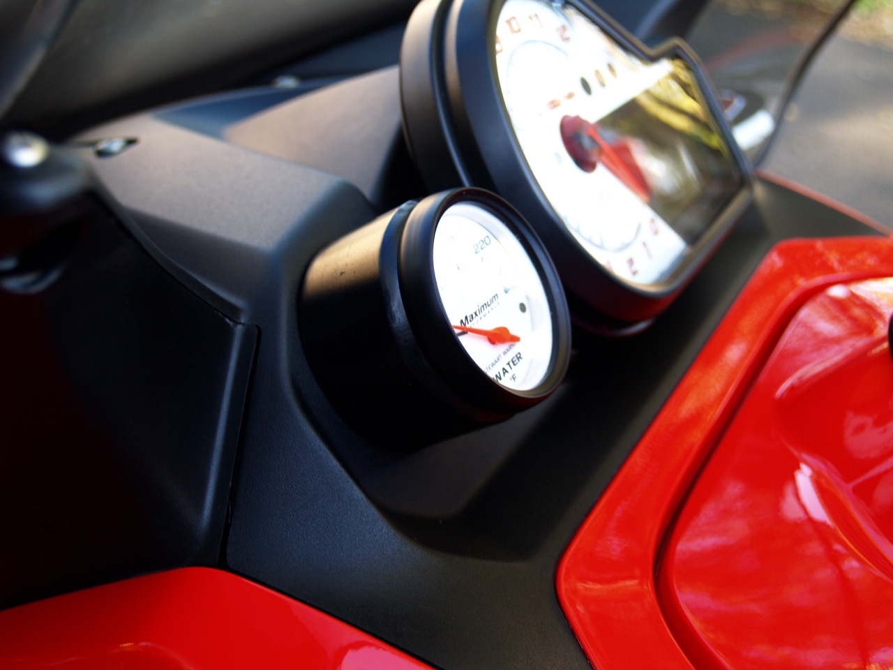

Here are a few pics of my instalation.I did not flush mount my gauge as I wanted it to be the same height as the speedo, also I did not want to cut a 2 inch hole into the dash. It is a Stewart Warner Gauge. In my opinion,a gauge is not something you want to "cheap-out" on .Im sure that these gauges were made for automobiles, and we are subjecting them to an enviroment that is way more harsh than what they were engineered for.

That's a nice clean look - Good Job...
local 25 said:Here are a few pics of my instalation.I did not flush mount my gauge as I wanted it to be the same height as the speedo, also I did not want to cut a 2 inch hole into the dash. It is a Stewart Warner Gauge. In my opinion,a gauge is not something you want to "cheap-out" on.
