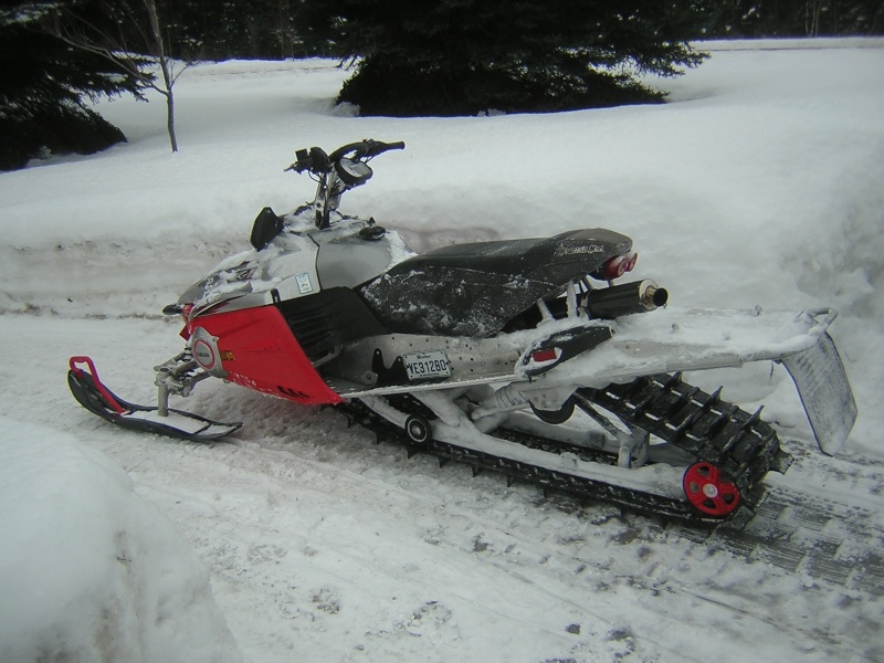

No issues at all. Just grind the 2 lips on the front cooler, and everything is fine.
Its the best money spend to date on my sled. Forget suspension, seat or rider forward, this track with clutching work is totally awesome. And trust me, she spin, but hook alot more than the maverick. Sled feel weird to control with that much track and rider forward, not easy as i would, but that will save you a lot of pulling and lifting.

Nice pictures!
I agree, the Extreme rules! We were riding in neck deep powder yesterday and there was really no comparrison in ability to get around between the two sleds with Extremes and two sleds with Mavericks, but I won't tell them because they think it's just their lack of riding ability.
