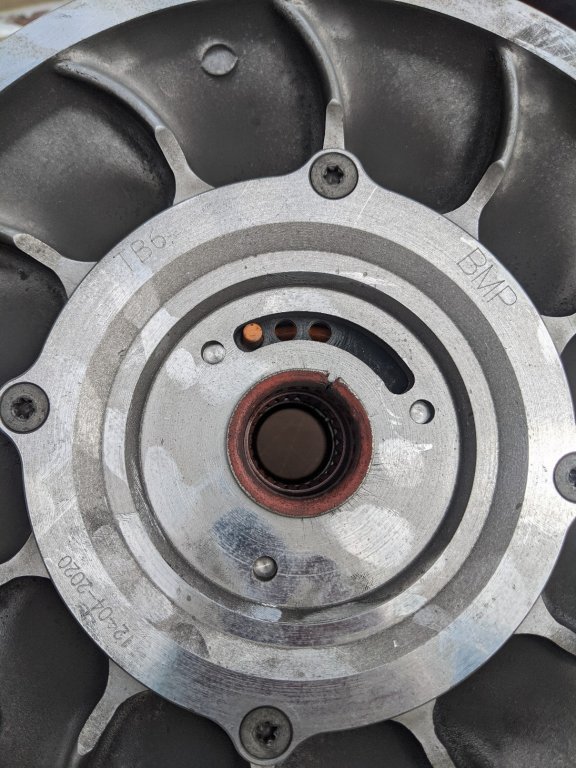

So this is what I'm looking at for the compression

Bikeman states to use center hole to start with.So this is what I'm looking at for the compression

Center will give it more tension than where you are in picture, will make it snappier and less dog like.Bikeman states to use center hole to start with.

Tighter will be quicker back shift.

So not having this thing apart and forgetting about my button days. Looking at the picture is more spring pressure rotating it clockwise or do I need a stiffer spring since I'm already at max spring pressure.

Yes clockwise, and you have 2 holes yet for more tension, orange spring works just fine, no issues on that helix or spring on my end, i use center hole as long as hole was drilled in secondary in proper spot. Bikeman has a video on this secondary torsional conversion.So not having this thing apart and forgetting about my button days. Looking at the picture is more spring pressure rotating it clockwise or do I need a stiffer spring since I'm already at max spring pressure.
